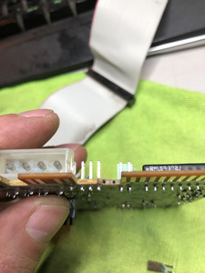

Reply 50841 of 53103, by DerBaum

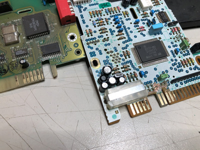

Kahenraz wrote on 2023-11-09, 02:16:
It might not be possible to repair this reliably for insertion and removal. But what you can do is cut away part of the protective housing of a connector and solder a bodge wire from from the pins to the PCB. Then, add some hot glue for mechanical support.
Because i am a little bit insane i drilled 2 0,7mm holes inside the pcb and the part i cut out of an old isa modem...
then i inserted pins from a pin header into the holes and superglued it together. the tiny gaps (where you could see superglue) i have filled with pcb saw dust from cutting the replacement.
it feels rock solid. i am actually surprised that it even worked...
1.06 MiB
1554 views
1.61 MiB
1554 views
1.93 MiB
1554 views
Now i just need confirmation of the traces.
FCKGW-RHQQ2

Reply 50844 of 53103, by Kahenraz
The only thing I would be worried about, drilling from the side like that, is shorting out a trace, via, or ground plane. You should be able to see what's inside by shining a bright light from the other side.
This is a very old PCB, so maybe this won't be a problem, but it does give me pause. Cosmetically, it looks great otherwise.
Reply 50845 of 53103, by BitWrangler
By the edge of it, only looks like a 2 layer, top and bottom, but yeah, multilayer you need to check you're not cutting or shorting anything.
Reply 50847 of 53103, by DerBaum
Kahenraz wrote on 2023-11-09, 04:32:
The left hole is also very close to two vias. You wouldn't want to accidentally sever or short either of those.
I have checked that. it is just 2 layer. all vias around the drilling area are ground from the top to the bottom. i have calculated to hit them... And then the stabilisation pins are just ground...
but i have not hit them. i measured from the drill bit to all nearby vias and components.
Until now it looks good.
FCKGW-RHQQ2

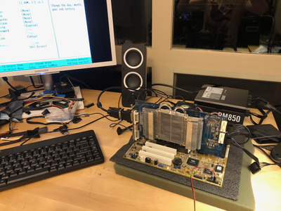

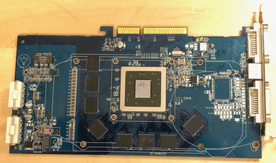

This showed up today:
I tossed $10 at an eBay auction with no bids and ended up getting it. It came with CPU, RAM and a I/O faceplate. Looks like it actually works!

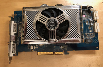

This fella is newer than what I usually mess with, so I was starting to think I didn't have an appropriate GPU for it when I dug up this thing I actually scavenged locally a while back:
1.54 MiB
1420 views
1.74 MiB
1420 views

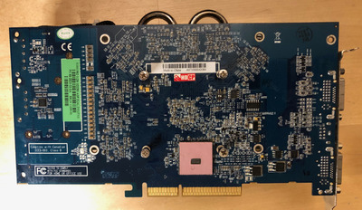

I must have some sort of mental block, because I just don't remember this era of GPUs. Assuming the hideous HSF is aftermarket. Still, why is the card so weirdly huge yet sparse?
1.19 MiB
1420 views
1.59 MiB
1420 views
Anyway it works, FWIW
1.49 MiB
1420 views
Looks way better without that plastic cladding, get a decent fan on it and might have something. 🤔

DerBaum wrote on 2023-11-09, 02:36:
That is an excellent repair ! What did you use to drill like that ?
Reply 50851 of 53103, by DerBaum

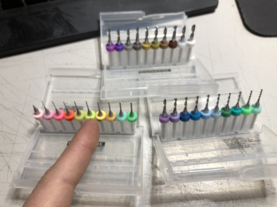

Tiido wrote on 2023-11-09, 12:52:
A local supermarket (Lidl) offered Microdrill sets for their "Dremel" clone.
1.03 MiB
1342 views
BUT i used the drill just with my fingers to have more control.
The drills are quite sharp. One hole took about 5-10 minutes by hand.
FCKGW-RHQQ2
Reply 50852 of 53103, by debs3759
Brings a new meaning to "hand drill" 😀
Reply 50853 of 53103, by Tiido
I will have to try this at some point, I didn't even think you could hand-drill this way 🤣. Definitely a great idea !
Reply 50854 of 53103, by BitWrangler

weedeewee wrote on 2023-11-09, 16:56:
looking at the pinout... I wonder, are any of those pins that were missing really required for the computer to interface with the drive ?
Every time i look a floppy pinouts i am more confused than before.
The teac drive is a multi speed drive. It should be abled to read many formats. I am not sure if the density select signal is used for that.
All of the pins that are missing have connections into the circuit (from the number of traces in the area).

ubiq wrote on 2023-11-09, 05:36:
This fella is newer than what I usually mess with, so I was starting to think I didn't have an appropriate GPU for it when I dug […]
ubiq wrote on 2023-11-09, 02:00:
This showed up today: IMG_6272.jpeg […]
Yeah that was a great score for $10 and quite a beast of a GPU you found for it, relative to AGP availability.

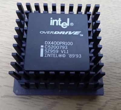

Can't wait to bench this beauty. (Upgrade from a SX 25.)
389.53 KiB
1910 views
DX4 100 Overdrive SZ959
