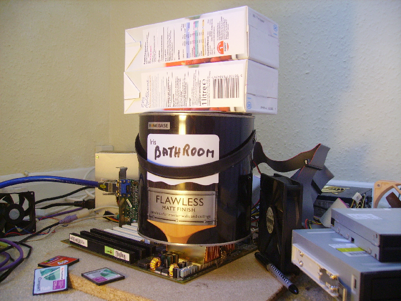

Dark voodoo: some more overclocking 233 MMX to 300MHz fun. I haven't got any socket 7 heatsinks (to hand), so I used a socket A/462 heatsink instead. The clips wouldn't clip on to the SS7 mobo because it was the wrong shape and size, so I used my dark voodoo overclocking skillz, and got some heavy objects from around the house. It works, but I might delay mass production of this heatsink concept until the design is tweaked a bit.
I set the mobo's options to: 100 bus speed (from 66), 3 multiplier (from 3.5), and 3.2 voltage (from 2.8 ). The Intel Pentium 233MMX chip was thus magically transformed to a molten hot slab of 300MHz goodness. Amazingly, the system appears to be stable. I had to open a window 5 minutes later because of the heat!
