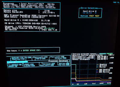

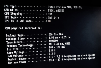

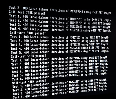

Reply 211 of 225, by NostalgicAslinger
Maybe interesting for somone:
I have found a mobile Pentium MMX CPU with 200 MHz, 2.45V, manufactured in week 25/1998 (https://www.cpu-world.com/sspec/SL/SL2Z8.html). It runs fine on any desktop mainboard and also has a free mutliplier until 3.5x. This CPU runs fine with 300 MHz (100 FSB x3) and is completely stable with 2.8V (Prime 6+ hours run tested, 2.7V was only bench stable). CPU Cooler was a SPIRE FalconRock II CPU cooler with CoolerMaster thermal compound!

Reply 216 of 225, by feipoa
Does it have SMP enabled? Or disabled like the Tillamooks?
Reply 217 of 225, by NostalgicAslinger
Here are some screenshots (only with cellphone camera):

Mersenne Prime 23.9 after +5 hours with 300 MHz and 2.8V

Would you be able to post some game benchmarks with the same CPU at 200Mhz and 300Mhz? Whatever you have access to: Quake, Doom, PC Player Benchmark, etc.
