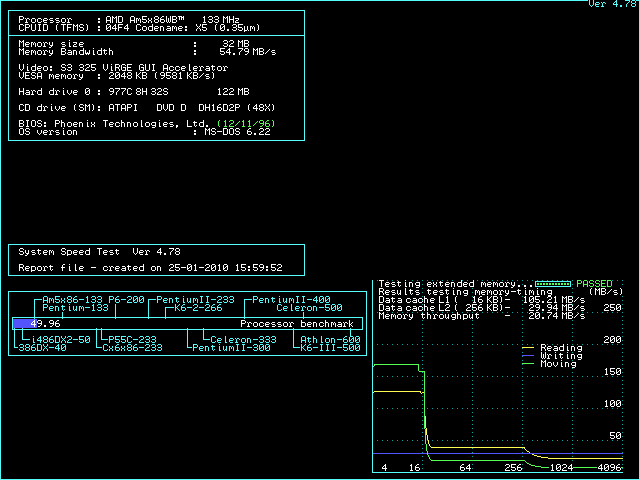

I put on my environmental harzard suite, and ventured forth in to the attic of doom. There, lurking in the shadows of horror (tm), I found a mobo that I bought from some guy in Sweden. Hehe! It's a UMC chipset based board, model number UM8810PIAO, PCB revision 2.1. It's got a Voltage Regulator Module (VRM) attached to it, with an AMD P75 CPU. This CPU is labelled: AMD-X5-133ADW
I removed the two 16MB Fast Page Memory sticks (32MB total) from the FIC mobo, and put them in to this UMC board. I grabbed the nearest graphics card to hand (an S3 Virge 325 2MB PCI), and ran some benchies. As seen in the Speedsys screenshot, the memory bandwidth is better on this mobo, compared to the FIC mobo.
I ran "cache check 7", and this is what it said:
This machine seems to have both L1 and L2 cache. [reading]
L1 cache is 16KB-- 135.4 MB/s 7.7 ns/byte (548%) (315%) 3.9 clks
L2 cache is 256KB-- 42.9 MB/s 24.4 ns/byte (173%) (100%) 12.4 clks
Main memory speed -- 24.7 MB/s 42.4 ns/byte (100%) [reading] 21.6 clks
Effective RAM access time (read) is 169ns (a RAM bank is 4 bytes wide).
Effective RAM access time (write) is 124ns (a RAM bank is 4 bytes wide).
"AuthenticAMD" 486(5x86) Clocked at 133.4 Mhz. Cache ENABLED.
I then ran CTCM7, and it said:
Primary Cache (L1) : 16 KByte, 4way associative
Secondary Cache (L2) : 512 KByte, direct mapped
Code Cache (L1) : unified with Data
Main memory : 32 MByte, no Memory holes found
Cacheable Area L1 : 32 MByte, no noncacheabled Areas found
Cacheable Area L2 : 32 MByte, no noncacheabled Areas found
Pcpbench (Default mode 100, LFB) = 6.7
The next thing to do is to remove the AMD P75 CPU from the UMC board, and put it in to the FIC board. I will also adjust the FIC board's FSB from 33 to 40. (Can I go as high as 50?)

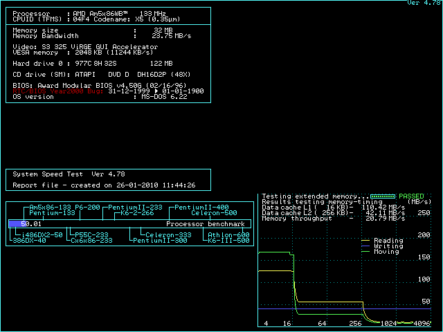

I removed the Cyrix 5x86 100mhz CPU from the FIC board, and replaced it with an AMD 5x86 133mhz CPU. Pcpbench scores 6.1. Previously, using the UM8810PIAO mobo with this AMD CPU, I got 6.7. I then run cachechk7, and it says:
L1 cache is 16KB -- 137.5 MB/s 7.6 ns/byte (1155%) (222%) 3.9 clks
L2 cache is 256KB -- 61.8 MB/s 17.0 ns/byte (519%) (100%) 8.6 clks
Main memory speed -- 11.9 MB/s 88.0 ns/byte (100%) [reading] 44.8 clks
Effective RAM access time (read) is 352ns (a RAM bank is 4 bytes wide).
Effective RAM access time (write) is 92ns (a RAM bank is 4 bytes wide).
Also, please see Speedsys screenshot for this FIC mobo + AMD CPU combo below.
Things to do: is it possible to increase the FIC mobo's FSB to either 40 or 50? Also, I can't find CTCM.exe on the net. If someone can provide a DL link, I'll run it on the FIC board before I dismantle this testing rig. Thanks.

I don't understand why your memory throughput is so low on that board. I have a Micronics board with an Intel chipset, and no memory adjustments at all in the BIOS running a 66MHz DX2 that gets around 29MB/s! Are your memory timings for the L2 cache and main memory set at the fastest timings available that will allow the board to boot?
I guess the poor main memory throughput is due to the VIA chipset perhaps? I dunno. VIA never really impressed me even in the AMD Athlon XP era....had a KT133 board and a KT266 (both non A revisions) and those were both problematic and slow too!
CTCM7 will typically lock up right after showing the cacheable areas on a 486 board, as the next tests it does only seem to work on Pentium and above CPUs. CTCM.exe will work on a 486 board and give you some detailed memory throughput results.

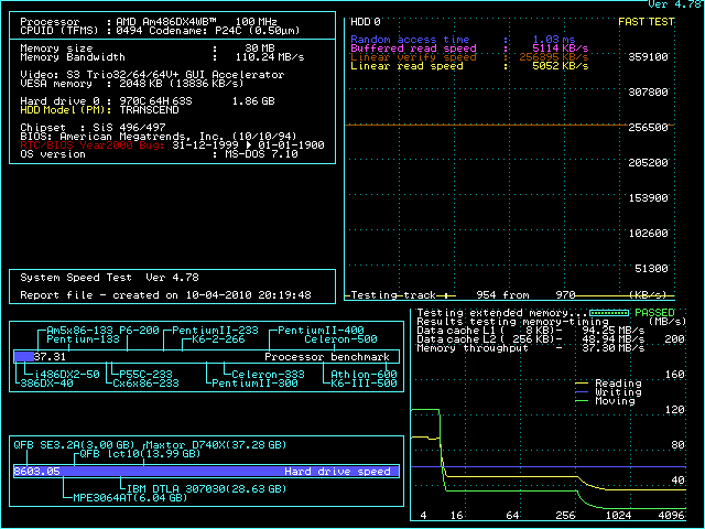

Thanks a lot for the CTCM link. Unfortunately, I don't have that FIC mobo immediately available, but I have just tested CTCM on another 486 mobo. It's an MS4144, PCB revision 1.4. (4 ISA, 3 PCI, SIS 496/7 chipset, 256K L2 cache.) It's got an AMD DX4-100 (WB cache) CPU in it, with 2 sticks of 16MB FPM (32MB total), and a 2MB Trio64v+ graphics card. I ran CTCM, and it says:
Processor CPUID: am486DX4-WB/ Typ:00 Fam:04 Mod:09 Stp:04
Clck: 99.5 MHz
internal Bus: 32 Bit between CPU and primary Cache or Memory
FPU: i487-Typ
L1 Cache : 8 KByte, 4-way associative
L2 Cache : 256 KByte, direct mmapped
Write Strategy L1 : Write Back
Write Strategy L2 : Write Back
Dirty Tag L2 : ok
Through Put & Bus Performance : Main memory from 00120000
Best Time for 8K MOVSD (Cache /Page Hits) : 65 mcs - 125.1 MByte/s
average t. for 8K MOVSD (Miss + Hit) : 234 mcs - 35.0 MBytes/s
average t. for 8K MOVSD (if clean) : 310 mcs - 26.4 MByte/s
average t. for 8K MOVSD (if dirty) : 526 mcs - 15.6 MByte/s
Main Memory 8K MOVSD (Cache misses) : 613 mcs - 13.4 MByte/s
average with 256 KB L2-Cache /DOS (640K) : 265 mcs - 30.9 MByte/s
average with 256 KB L2-Cache /WIN (4M ) : 334 mcs - 24.5 MByte/s
Also, a speedsys shot is included below.
Edit: I ran pcpbench, and I get a score of 7.0. I ran Superscape 3DBench, and I get a VGA score of 62.5 frames per second.
