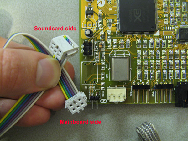

3) I need an SB-Link cable. Can I buy or make one?
Don't know if you can make one. I made one. You will need some components.
Reply 25 of 43, by gerwin
Behold!
    101.92 KiB
    6786 views
    Home-made SB-link cable
