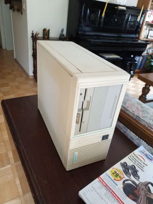

Retrobrighted my K6-2 System and my father's old 286 Tandon the last few days 😉

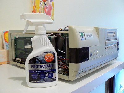

I wonder if using 303 Aerospace Protectant will help to prevent yellowing again - it's a UV protection made for plastics (used in boat / automotive industry). It's easy to apply and easy to remove - although that's not necessary because it doesn't alter the color. I recently did retrobright on an old AT case and old Roland speakers and I applied 303, so let's see if it will help. But it will take few years to find out 😀. Also the 303 is not a permanent protection, you will need to reapply it from time to time, but it will probably take months indoors until it disappears from the surface. I think it should because it also partially seals the plastic surface so that less oxygen will "oxidize" the plastic (yellowing isn't just caused by UV, there are multiple factors, it's also caused by oxygen and heat itself. There is a good short article on the yellowing process and it also debunks some myths around it- https://medium.com/@pueojit/a-look-into-the-y … cs-db14b646e0ad).
Reply 24 of 57, by badmojo
I've given my retro plastics the 303 treatment but only started doing it about 6 months ago - impossible to know if it will have a positive effect but it can't hurt I don't think.

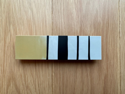

I started now a test where one part of retrobrighted plastic is covered with electrical tape - this will prevent oxygen access. And then I also applied Renaissance Wax to one strip, 303 to another and then I left one untreated and original condition. I will leave it near a window and hopefully I will report back the results in 1-2 years 😀.

It dries quickly and then you can polish it, it's not visible at all and it's the most safe wax you can use. It has a very slight shine to it, but in case of plastic you can't tell the difference at all. It should be completely safe to almost any surface, that's why it is used to preserve even very old artefacts in museums. It creates a barrier on top of the surface to prevent further degradation from oxygen / moisture.
