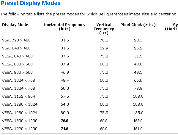

Reply 9 of 22, by retro games 100
Mau1wurf1977 wrote:
They all scale. Check the manual (which you can often download) and look for 1:1 pixel mapping or aspect ratio scaling
That's a good idea. I've just done that, for the Dell U2410 monitor. It's on this page:
http://support.dell.com/support/edocs/MONITOR … en/ug/about.htm (See "Preset Display Modes", about 60% down the page.)
And it looks encouraging. They guarantee 1600x1200 will work, at 60Hz. I wonder how the old VGA DOS stuff will work? Would the monitor automatically select 720x400 @ 70Hz, or 640x480 @ 60Hz? At the moment, my 5:4 19" LCD selects 720x400. I'm not sure if it is able to select 640x480 - I've never seen it do this. However, 720x400 @ 70Hz looks OK, in pure DOS.
    8.33 KiB
    3040 views
Reply 10 of 22, by Mau1wurf1977
Yea I wouldn't worry about resolutions as much as LCD take whatever you put into them and simply scale / stretch it to the native resolution.
So if you have a 4:3 LCD screen and you put in a 4:3 signal (whatever resolution it doesn't matter) you will get a 4:3 full screen image...
On a 24" I have my doubt about 320 x 200 games. I doubt they considered this input resolution when they designed the monitor. There is only one way to find out and that's test before you buy!
