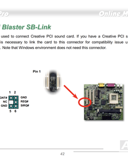

Thanks for this thread, it has been most helpful, I was trying to get my SB CT4B10 to work on my mobo under win98 and it has this SB Link. The manual says it needs this to use the SB in DOS, well it appears that because the sound card itself doesn't have the SB link option it won't work anyway !
I've attached here the info on the pins from the mobo manual.
Reply 33 of 33, by gdjacobs
The CT4810 doesn't support either sideband option for DOS audio emulation. The driver uses EMM386 to intercept hardware calls and route them to the card. Ironically, Creative Labs only produced one family of cards which support SBLink -- AWE64 PCI or AWE64D sounds cards.
