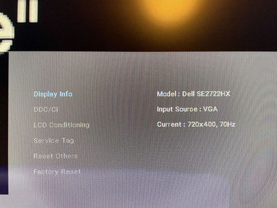

Hi, i ordered this display because of the 15khz amiga support (not tried yet), but the dos vga 13h 70hz also looks native - the scrolls are smooth. It was just 110 eur from the amazon on prime days. The mode switching is also fast.

It officially support 75Hz, so of course 13h 70Hz won't be a problem. The main issue is 1080p though, which is not optimal for for scaling 200(240)p/480p content.

Which modern display resolution is suitable for 200/240?
