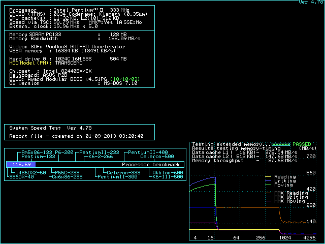

Finally obtained a Klamath core Pentium II.
It is a 233MHz part, SL2HD, Malay, Produced week 08 1998.
Tested this processor on an i440BX board, the Asus P2B rev 1.04. With its VRM chip replaced and an AGP divider jumper added.
I found multiplier jumper BF3 is ignored, jumpers BF0/BF1/BF2 work like this:
BF0 BF1 BF2
O - X - O -> No Post
O - O - O -> 133/66MHz (2.0x), No L2, Speedsys 154,80
X - X - X -> 133/66MHz (2.0x), No L2, Speedsys 154,80
X - O - O -> 133/66MHz (2.0x), 512kB L2, Speedsys 154,80 <--- !!!
O - X - X -> 166/66MHz (2.5x), 512kB L2, Speedsys 193,52
X - O - X -> 200/66MHz (3.0x), 512kB L2, Speedsys 232,26
O - O - X -> 233/66MHz (3.5x), 512kB L2, Speedsys 270,98
X - X - O -> 266/66MHz (4.0x), 512kB L2, Speedsys 309,70
(O means 1-2 is jumpered. X means 2-3 is jumpered.)
Now other people have done this before, but there were some doubts about wheter L2 cache remains functional at 2.0x on an i440BX.
As to the upper limit: This CPU runs 300MHz @ 100FSB and 266MHz @ 133FSB, but does not boot at 350MHz @ 100FSB or more.
For changing the FSB speed on several i440BX mainboards there is also a DOS program, which also works in Windows 98: SMB by Rayer. Combined with a Dos Batch selection menu it works like SoftFSB did. Tested OK with PLL chips of the type ICS9148xx-26 and ICS9150xx-08.
Edit: corrected processor speed

    My new Pentium II/III 'Low' milestone with L2 enabled at 50MHz FSB

Usually I underclock instead of overclock CPUs. But with these oldest of Pentium II's, Klamath core, it is easy to forget that speeds like 350MHz are already too much to ask. 😉
Would like to know the speed rating of the L2 cache chips, but I don't want to break another plastic CPU package.
(Correction on my previous post: SL2HD is a 233MHz part)
133MHz FSB is overclocking the mainboard. Official specification is either 66 or 100MHz. Although it is generally found that the i440BX chipset itself is fine with a 133MHz FSB, other mainboard components and expansion cards may not be, especially AGP video cards at 2/3 divider.
Recapping is certainly a thing to consider, if only because these mainboards and PSU's are from 1998-2000. But lets hope they will hold out fine for a few years more.
I am thinking: In my last test with a Klamath core at 2.0x multiplier, the L2 cache throughput is near that of the SDRAM. So at that multiplier the later Deschutes core Pentium II's are practically performing the same, despite their non-functional L2 at 2.0x: More reason for using the cooler and faster Deschutes core over the Klamath.
As to the multiplier jumper settings on all tested unlocked slot-1 and socket 370 intel CPUs: XXXX and OOOO always gives a rather odd result. As if these two settings were somehow not intended for normal use, some kind of 'test' mode.
