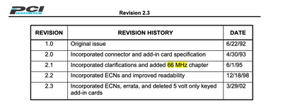

Reply 225 of 755, by Anonymous Coward
Wasn't the 66MHz operation introduced with PCI 2.2?
Reply 226 of 755, by mpe
No it was in 2.1
download/file.php?mode=view&id=74915

Reply 227 of 755, by Doornkaat
Doornkaat wrote on 2020-01-20, 08:05:
Quick OT: Does PCI revision > 2.0 dictate 66MHz capability or does it merely specify how 66MHz are to be integrated?
Is every PCI device > rev.2.0 66MHz capable or are most of them 33MHz devices but the same specification allows for 66MHz on devices that support it?
Thanks!
Anyone?
Reply 228 of 755, by Tiido
66MHz is an optional feature that can be enabled if all the devices on the bus can handle it, including chipset itself. There's a pin on the slot that tells if something cannot do 66MHz, if that pin is active then 66MHz won't be enabled on the bus.

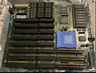

Reply 230 of 755, by Intel486dx33
What socket 3 , VLB motherboard and chipset do you recommend ?
I am shopping for a better motherboard and I want a good fast reliable one for an Intel 486dx4-100 CPU.
Reply 231 of 755, by The Serpent Rider
Probably PCCHIPS M912 Rev 1.7, the one without fake cache soldered on.
Reply 232 of 755, by Intel486dx33
The Serpent Rider wrote on 2020-01-22, 23:49:
VLB, Not PCI.
How is this motherboard ?
Is this “Symphony” chipset any good ?
I want to use it with an intel 486dx4-100 overdrive CPU.

Reply 234 of 755, by The Serpent Rider
VLB, Not PCI.
M912
Nothing spectacular. Also SIMM30, which is a pain.
Reply 235 of 755, by ph4nt0m
PCChips M912 aka Cheetah has a very thin PCB. Especially the last v1.7. The capacitors are no good either. The good thing is that it can handle 1Mb of cache and 40MHz FSB.
ECS UM4980 is about the same with a much thicker PCB, but it doesn't come with a voltage regulator. Either you DIY or just use a 5V capable CPU including overdrives. Also no RTC battery, so you have to attach an external one.
