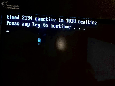

Yep I had to use the lowest cache timings with the 15ns cache I have in the C2. I tried 66x3 and was able to beat my previous score just a bit. Serpent was right about Doom preferring the faster bus speed. Really wanted to get Quake running but kept hitting malloc errors when launching, kinda similar to what happens when I try running this cpu at too high a voltage at 180. I bet if I could dial in the voltage between the 3-4v jumper setting I could get Quake running.
