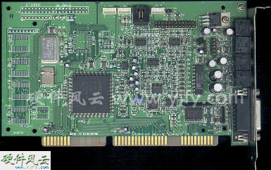

I have the CT2940 SB16 installed for a little while now. It is a CT2940 with OPL3-L instead of that nasty CQM FM Chip. So far it seems to be an improvement over using the CT2800 or the AWE64 Gold.
- Compared to the AWE it has way better FM output.
- Compared to the CT2800, the whistle problem is audible in Tyrian setup, but hardly. In other games I can not find any audible whistle.
I am am using speaker out with this test setup, so the amplifier is important here too. The noise floor seems to be just one notch lower then the CT2800, as in, the CT2940 is a bit more silent. I remember the AWE was more silent then both the SB16s. But as the awe has no amplifier on the card, that is not a fair comparison.
The Low Voltage OPL3-L seems to have this difference with the classic OPL3:
OPL3: 49,7 kHz sampling frequency
OPL3-L: 44,1 kHz sampling frequency
Looking at the AWE-64 Gold again, I remember they advertised a 20-bit DAC. but the DAC chip is the same as on many other AWE cards.
    34.44 KiB
    5690 views
    CT2940 with OPL3-L
