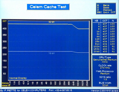

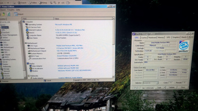

Scored SL2Z4 Tillamook for a whopping 5 euros on local auctrion site and finally got a chance to try the mods listed in the thread, 15 minutes with soldering iron and put the CPU into my PC Partner MVP3BS7 that I got from the same auction site a year or so ago for also whopping 5 euros and voilaa! It works!
It needed 2.2 volts to be 100% stable at 4x100 MHz but I am glad that everything works, cache shows 512kb and it is quite fast.
I threw in Asus Geforce2 MX400 64MB and just for fun installed NFS Hot Pursuit 2 😁 It "ran" or to be more precise walked at best. All settings at minimum @640x480 it made ~10-15fps, sometimes dropping below 10 at heavy areas. But it worked and that was very good test for stability, gave proper workout 😀 I obviously uninstalled the game afterwards, at least now can say that this CPU is quite fast!

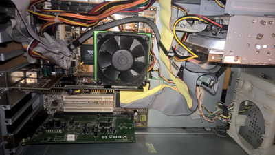

What is this fan used to cool your processor?

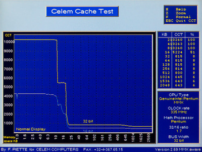

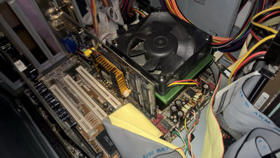

Hi, after fighting with some issues I managed to reuse old de-soldered mobile Tillamook in TCP320 package (I have only this one).
described in separate thread: Interposer for mobile Pentium MMX Tillamook
Now I'm trying it to run in some S7 MBs I have handy:
* PC-Chips M590 - this MB needs VCC2DET bridge otherwise onboard VRM keeps shutdown and MB will not even POST. This is because CPU voltage autodetection - this MB can set Vcore only via SETUP menu, no jumpers. L2 cache works on this MB without bridges. Problem is that this MB use very high VIO - I measured 3,86V instead 3,3V that is too high for Tillamook. I think they did it to be able to overclock the crappy chipset to boast supporting 100MHz FSB (without letting user know they overvolted his CPU and RAM heavily to do this). I'm planning to replace onboard VIO regulator (some strange circuit using power N-FET and small BJT?) with normal 3,3V LDO. Problem is that FET and LDO, both in TO-252 cases, have swapped in and out pins so I cannot reuse the copper plane for cooling, I don't know what current the VIO consumes for proper dimensioning the LDO...
* Gigabyte GA-5AA rev 2.2 - this MB needs cache bridges mod otherwise I got blank screen after POST/before boot until I disable L2 in SETUP. After the mod L2 is working but I have a problem with L1 - SETUP list this option as "Reserved" and while I can change to "enabled" or "disabled" it doesn't change after save settings and L1 don't work. This degrades performance to some 486 level. Is there some DOS tool that can enable L1? I remember people used some utils to disable L1 to decrease system power for some old games...
BTW this MB use VIO set to 3,5V and maybe there's normal regulator with resistor feedback network that I could tune, didn't investigated yet until L1 problem will be solved. Any newer unofficial BIOS this MB? I read here someone succeeded with GA-5AX...
