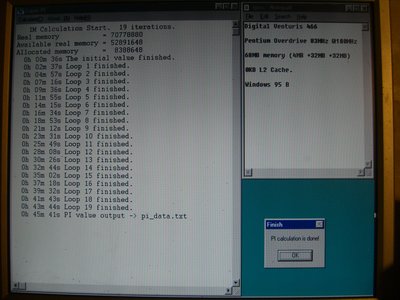

The same Digital Venturis Socket-3 system but with the Pentium Overdrive running at 100 MHz.
POD@100, no L2 cache.

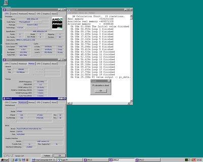

Athlon 1200, 512MB PC133 SDRAM @ default settings, W98SE:
117.21 KiB
1975 views

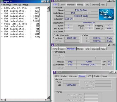

Pentium 200, 64 MB 60ns EDO ram @ default settings, W98SE:
90.92 KiB
1975 views

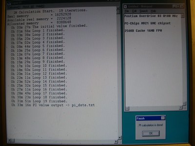

Reply 262 of 328, by Skyscraper
The Digital Venturis Socket-3 system was rather slow as it lacked L2 cache. I thought I would test a Pentium Overdrive at 100 MHz with my PC Chips M921 UMC Chipset motherboard, the 256KB cache on this board is amazingly not fake.
If I upgraded the cache on this PC-Chips M921 board to 512KB and used Windows 2000 I think I would get a very competitive score. Using Windows 95B and with only 256KB L2 cache this is still my best SuperPi 1M score with a Socket-3 system.
POD83 @100, PC-Chips M921 UMC chipset 256KB Cache, 16MB FPM. SuperPi 1M: 33m 16s.
4.39 MiB
1948 views

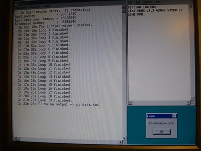

Reply 263 of 328, by Skyscraper
A normal Pentium with double the memory bus width and 66MHz FSB is much faster than the POD @100 when it comes to SuperPi 1M!
P100, 5DHX v1.2 512KB cache, 32MB FPM. SuperPi 1M: 22m 26s (W95B)
4.45 MiB
1920 views

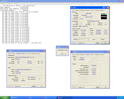

Upgraded my Socket A rig from a Thunderbird 1200 (SuperPi results here) to a Thoroughbred 2400+. Not the performance boost I expected, but still quite an improvement:

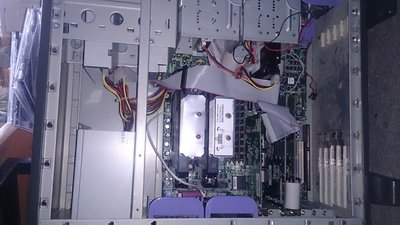

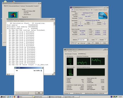

Reply 272 of 328, by matze79
350.84 KiB
1762 views
163.08 KiB
1762 views
Aopen Fortress 5000 Mainboard with 2x Xeon 550Mhz (Pentium 3 with 2Mbyte Fullspeed L2 Cache).
GeForce 6200 AGP 128bit 256Mb DDR.
512Mb ECC SDRAM PC100
SuperPi on One CPU.
System: Pentium III 933Mhz/VC820/256MB RDRAM PC-800/WinME
3m 9.189s
Wow only almost 10 seconds faster, Cache really counts in SuperPi 😀

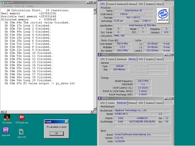

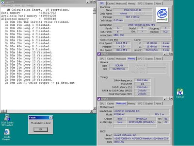

Reply 275 of 328, by Skyscraper
Here is a Katmai 550 on a dog slow Gigabyte BX 2000+ board.
268.64 KiB
1745 views
And here is a Katmai 600 on a HP/Asus P2B98-XV board, I do not think this board is very speedy but it's at least faster than the Gigabyte board.
152.25 KiB
1745 views
Notice that these scores are with Windows 98SE, in Windows XP the scores would have been better. The scores are at least a year old.

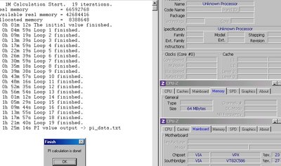

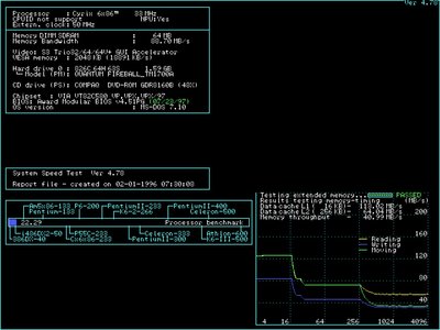

I posted this in another thread but I might aswell post the result here in the correct thread aswell.
Cyrix 686 33 MHz (CPU=FSB=PCI=33)
FIC VA-502 (VIA VPX)
64MB 168pin SDRAM
S3 Trio64V+ 2MB PCI.
256KB L2 Cache in WB mode.
All BIOS settings at the fastest values.
Linar Burst supported and activated.
167.74 KiB
1669 views

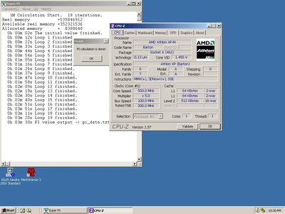

Reply 279 of 328, by Imperious

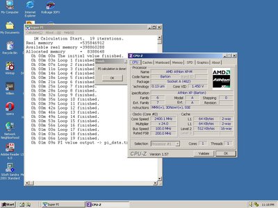

A few results with my Athlon XP Barton equipped KT7-RAID at speeds of 500mhz, 2000mhz, and 2400mhz. I was hoping to crack the 1 minute mark
but don't think that's possible with Cas2 133mhz sdram as opposed to the DDR RAM that most chipsets with a Barton would be running.
    158.84 KiB
    1638 views
    159.23 KiB
    1638 views
    144.3 KiB
    1638 views
