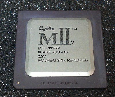

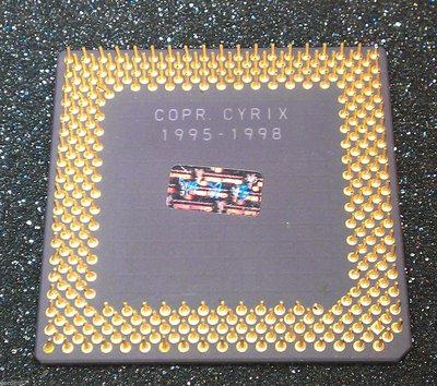

I have got my silver top Cyrix MII 2.2V "flip-chip" CPU and done some quick testing.
It runs stable at 3x100 with stock voltage but wont even load Windows at 315 without me giving it 2.3V, these CPUs seems to reach a brick wall.
3x100 MHz for a speedrating of 433 was all I hoped for but isnt it a bite strange that a supposedly 0.18 micron CPU wont go higher as the K6-3+ can do 600 MHz?
(The sellers pics)
364.96 KiB
3298 views
401.1 KiB
3298 views

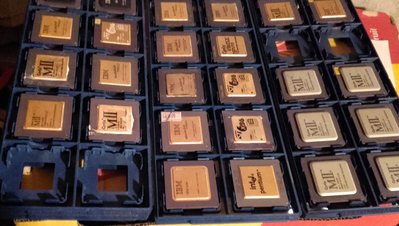

Reply 212 of 405, by BSA Starfire
About time I showed off my Cyrix 6x86 collection. I have 2 other in use, a Gold top MII 333 in my TIME ALi Aladdin 5 & a IBM 6x86 MX 333 in a SiS system.
1.05 MiB
3292 views

Reply 219 of 405, by Tetrium
I was in the attic for a couple other reasons and at some point was taking pics and well, here's my stored collection of Cyrix Socket 7 chips (somehow a single Pentium snuck into the pic).
It's only these 3 trays though, may have one or 2 chips somewhere else.
372.96 KiB
3008 views
