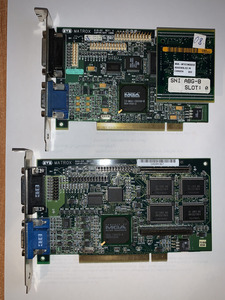

Thank you for this thread. I actually test my matrox mystique-cards against some software. I do not use the Desktop shown above. I use a smaller one. I used it with my G2+/16MB PCI but that card died yesterday. Now I have to use my mystique cards. But I have one BIG!!! issue with the mystique-cards. Hardware-Scrolling is broken. With the G200 (G2+/16MB) everything was fine, but now I see tearing and stuttering. I have tested three different drivers, none of them offers stutterfree scrolling. I this a feature that was later implemented? I donÄt think so. Only one game works stutterfree, all others are broken.

Reply 35 of 61, by dr.zeissler

Reply 36 of 61, by dr.zeissler
Should I make a new thread? I would be much more interested in EVERYTHING that works on mystique regardless if MSI, or D3D specially optimized settings for mystique.
Reply 37 of 61, by dr.zeissler
Are there any mystique users here. I would like to know what driver are you using in win95 and what dx-version.
I just found out that only the very latest driver from 1999 provides vsync on mystique in win95 ddraw.
Reply 38 of 61, by anakin94
I'm using the Mystique 220 with the driver which is provided in the DirectX 6.1 package.
It should be similar to version 3.70.
I'm using this, because is has not the slowdown issue with Colin McRae Rally on the main menu.
The ,,README" on the game disc says, that driver version 3.82 works properly and newer ones have this issue.
For me i found out, that's not true.
I'm using Windows 98SE.
Enhanced for Matrox Mystique
Reply 39 of 61, by dr.zeissler
Ah ok, that's interesting. So you override the driver in the dx-setup but it's not recommended by the dx-installer.
How do you set the monitor frequencies. I have to lower them to 75hz and especially 640x400 to 70hz to get Jazz2 smooth.
not MSI but early D3D)> if you use DX61 you can play GTA2 in D3D mode. It runs excellent smooth and looks beautiful!
