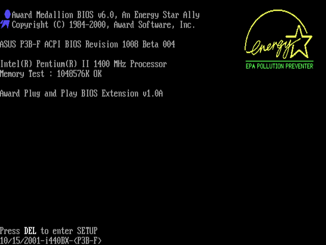

I'm running 1024MB on my 440BX system with Win98SE and Win95 (limited to 768MB through settings), no problems whatsoever.
Really? I thought 440bx was limited to 3x256mb? The i440bx RAM FAQ says:
"No 512MB module will work in a board with the bx chipset, regardless what a vendor might tell you on the website."
Yes really. The Asus P3B-F got 4 RAM slots and the maximum amount RAM on each module is 256MB.
Here is a screengrab (using my VGA capturecard) from my BIOS bootup screen I had taken earlier as part of a private clip for Maur1wulf1977 here on Vogons 😀 (My Pentium III-S Tualatin 1400mhz is reported as a Pentium II):

My Pentium III-S Tualatin 1400mhz is reported as a Pentium II:
My 1400MHz Tualatin Celeron (via slot-1 Powerleap) is reported as a "Pentium Pro 1200MHz" by the bios... Everything else detects it fine though. One of the other systems i tried it with just said "Unknown CPU Detected" but it still booted and worked just fine 😀.
