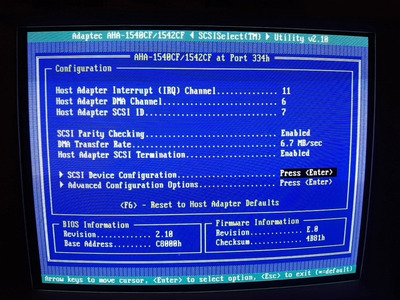

Iconclas wrote on 2020-01-20, 13:36:
The setup screen has a setting for 10 MB/s.
But where exactly?
AHA-1540CF is Fast SCSI, and Fast SCSI means 10 MB/s on the SCSI bus, not on the ISA bus.
I can see "DMA Transfer Rate" of 6.7 MB/s there - do you want to say you can select 10 MB/s as well?
Hard to believe it...

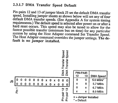

AHA-1540B has jumpers to select DMA transfer speed, and the max setting is 8 MB/s...

Reply 56 of 63, by luckybob
I'm going to chime in on the Isa scsi card.
That option is indeed for the Isa bus transfer rate, and 9/10 cases >5MB isn't going to work reliably. At least as far as emperical evidence goes.
Also, the vast majority of scsi drives (of this era) are not good enough to even surpass 5mb/s anyway. Unless you are putting new dries on adapters and shoehorning them on the narrow bus, and that's a whole 'nother kettle of fish.

Max selectable by jumpers is 8MB/s but you can push it to 10MB/s via a command line switch on ASPI4DOS
Reply 58 of 63, by luckybob
Also, the later revisions have it selectable in the bios to 10mb/s. (usually the PnP)
10mb/s is very possible in isa/pci setups when the isa bus has very little other traffic. Setups like pentium and newer. That said, if your system has PCI, you should use SATA and be done with it.
