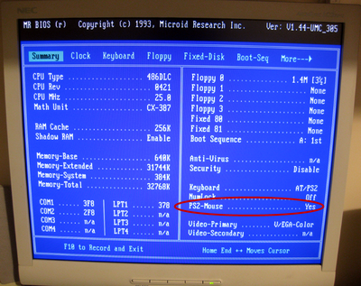

Update2: Mr BIOS for UMC 481/482 contains BIOS support for PS/2 mice. Adapter works in this board without needing Rio444's mouse driver. Upon adding the KBC module, the boot screen said "PS/2 mouse configuration change"
Update3: I am able to use the Logitech 7.20 drivers with MR BIOS for UMC 481/482 in DOS and Windows 3.11.

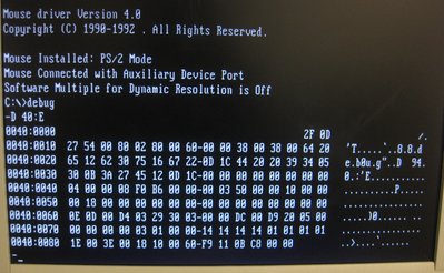

Could you view the contents of memory at 0040:000Eh using MS-DOS utility DEBUG?
Run Debug and type on the keyboard 'D 40:E' Enter.
And write here first four byte.
Do it before run the TSR and after.

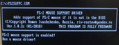

This is what the TSR says:
120.11 KiB

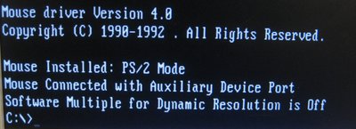

This is what my mouse driver says:
80.12 KiB

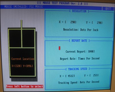

This is what the mouse test program says (mouse does not move, buttons do not work, computer is frozen):
432.28 KiB
2195 views
This is what Debug D 40:E looks like (computer frozen? I cannot type anything again):
289.37 KiB
