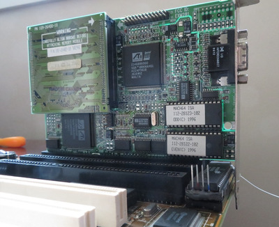

I pulled out a motherboard with the KBC between the ISA slot and the board's slot edge and tried to fit ISA cards with and without the KBC mod.
Here I am showing a slotted ISA card (Mach64 graphics card). You will notice that there is ample space between the ISA card and the KBC mod's top surface,
191.28 KiB
1453 views

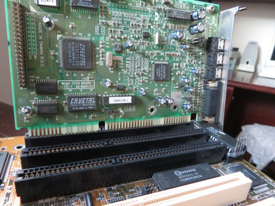

However, with a non-slotted ISA card (Magic S23 sound card), I could not even begin to insert the card into the ISA slot,
220.04 KiB
1453 views
Even without the KBC mod, the non-slotted sound card barely fits. If you look closely, you'll notice that the KBC chip prevents full insertion - there's a slight angle to it still,
238.46 KiB
1453 views
So if you are unable to position your ISA cards out of the way of the KBC, and you are unable to use slotted ISA cards, then your only option is to perform the mod on the motherboard itself. Many motherboards contain a 7406 inverter IC for the keyboard controller and usually have two unused inverters on the 7406. You would use these unused inverter in/out pins on the 7406 for your PS/2 mouse modification. In the first few pages of this thread, I show an example of doing the mod on the motherboard directly.
If you are able to find slotted ISA cards, you will still need to confirm that maxtherabbit's PS/2 unit is short enough to fit. My first thought after viewing the rendering is that it is too tall still.
How many ISA card slots does your motherboard have and how many ISA cards do you want to install? Worst case is that the KBC socket covers 3 slots. Best case is it covers only 2. If you have six 16-bit ISA slots and one or two 8-bit slots, you should be able to work around this limitation. For the most part, you can use 16-bit sound cards in the 8-bit slots. You can also use 8-bit serial, parallel, and IDE cards. It may be that you don't need any slotted ISA cards, or you can get away with using just 1 slotted ISA card.
