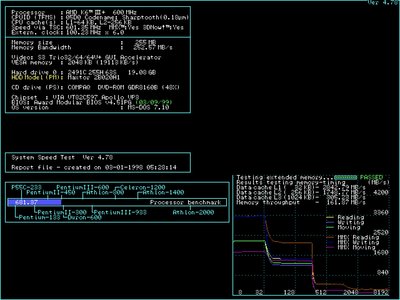

mv_cz wrote:
Yep, my MPV3 is only 512kB (when I had a mvp3 board back as new in 1999 it also had only 512kB). I've never met a 1MB L2 board around (two weeks back, there was one on the local auction supposedly with 1MB, but it was pcchips 😊 and the price went quite high) let alone 2MB L2 mobo 🙁
The PC-Chips M577 isn't a bad board.
I wouldn't pay insane money for one but something like 50-60 euro wouldn't be unreasonable if the board is in good working order.
The M577s cache and memory performance is nothing to sneeze at.
