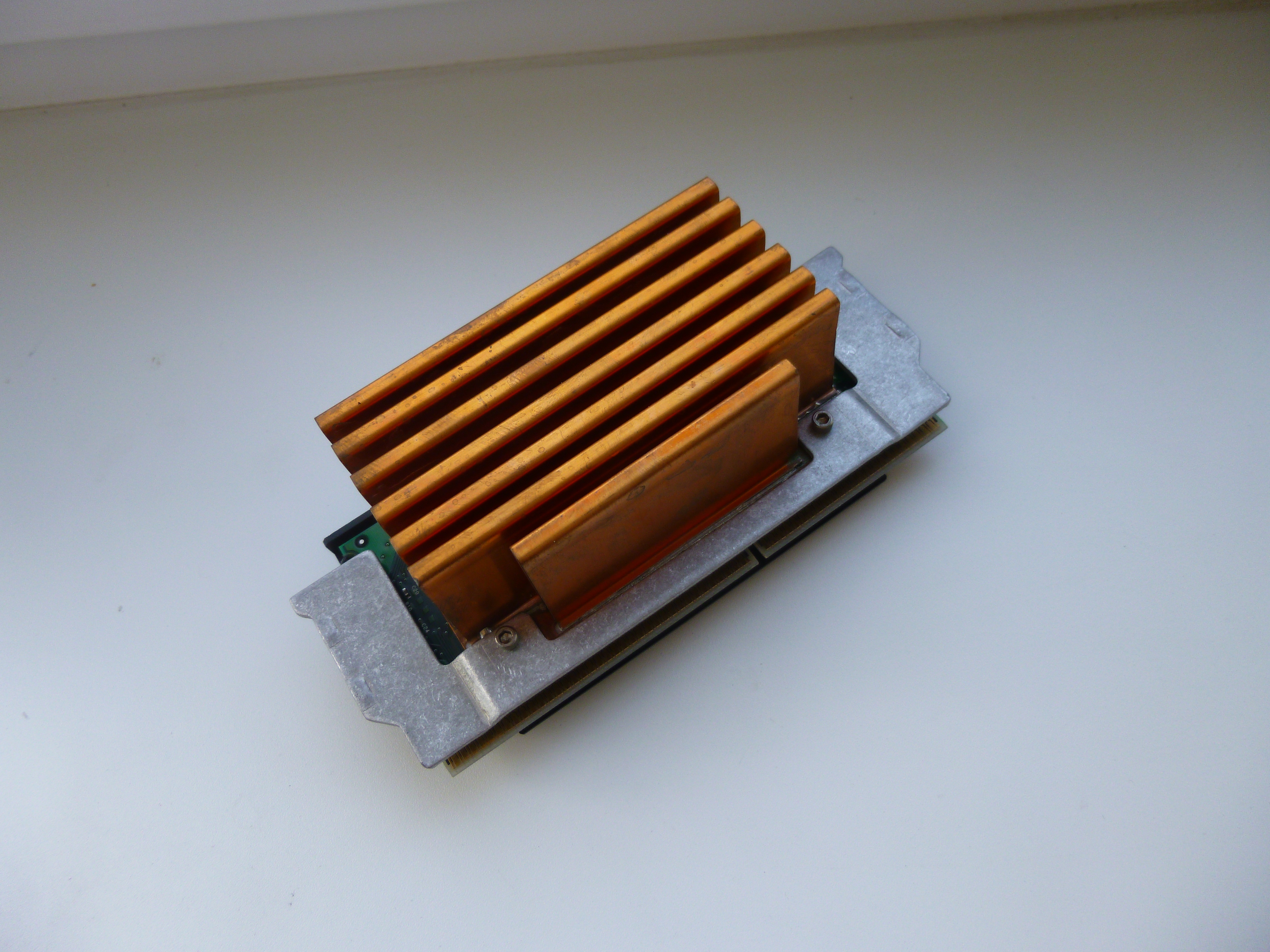

Reply 3 of 19, by bristlehog
I've got a fanless P3-933 that operates normally, however, it has a copper heatsink. I believe it was pulled from a Dell server.

Reply 8 of 19, by RacoonRider
In IBM PC-300PL P2-450 is cooled with a passive aluminium heatsink situated not far from the intake case FAN. Works good enough.
You can also use epoxy and thermal paste to attach a couple of socket 370 heatsinks with FANs. Be creative, cooling is easy to mod.
Reply 9 of 19, by laxdragon
I run a slot1 based P3 700 Mhz with a stock heatsink on it. Granted, I don't run it 24/7, but when I do boot it up and play a retro game or two it runs just fine.
I really should check the temp on it sometime.
That system is fanless (even the PSU) and runs from a CF card as well. So it is completely silent. Love it.
