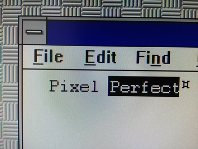

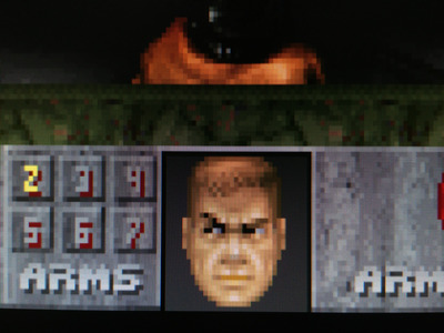

Reply 242 of 295, by cde
Thank you darry! I have received my OSSC and I'm pleased to say that together with my 144 Hz AOC 2590PX monitor everything works perfectly 😀 I've setup two profiles in the OSSC:
Profile 0 (used for 80x25 text mode):
  • Settings opt / Link prof->input / AV3: RGBHV
  • Sampling opt / 400p in sampler / VGA 720x400@70
  • Output opt / 480p-576p proc / Line2x
Profile 1 (used for 320x200 games):
  • Sampling opt / 400p in sampler / VGA 640x400@70
Below is a zoomed in screenshot of DOOM with Profile 1 and 17" 4:3 mode on the monitor. There is no input lag, the game is completely smooth (and Quake even more so).
1.44 MiB
2251 views
DOOM
GPL-2.0-or-later
The AOC G2590PX, in addition to 17" and 19" 4:3 modes, also has an excellent 1:1 mode (image is displayed as-is, centered). Together with Line2x above it provides pixel perfect doubling of 640x480 (and quadrupling of 320x240). Below are shown Jazz Jackrabbit and Windows 3.1:
902.83 KiB
2251 views
GPL-2.0-or-later
1.03 MiB
2251 views
GPL-2.0-or-later
With this setup all the problems I've encountered previously are solved: lack of VGA input on certain monitors, 320x200 games no longer have duplicated pixels (since they are sampled at 640x400, not the incorrect 720x400), games that rely on the vertical refresh interval for their internal logic run at the correct speed, and the aspect ratio is a correct 4:3. The only drawback that I see is that 80x25 text mode doesn't look very good when sampled at 640x400, but it takes just two presses on the remote to go back to 720x400 sampling.
Overall I would definitely recommend the OSSC despite it being expensive (about 100E), it is absolutely worth it. However keep in mind a monitor that accepts 1280x800@70Hz without frame dropping and provides a 4:3 option is required. darry has tested the Philips 252B9 with success, and I confirm the AOC G2590PX also works great. Which one is better depends on the games played. I believe the 252B9 is probably best for 320x200. The G2590PX is great for 640x480 with Line2x plus 1:1 option, and is also great for modern games, being 144 Hz and FreeSync compatible.

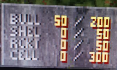

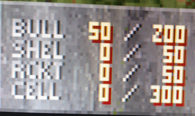

Reply 258 of 295, by cde
I found out an interesting behaviour of the GeForce GTX 960: when the VGA output is directly connected to the monitor, it outputs 1920x1080@60 which is not helpful.
However when connected to the OSSC instead, it produces a correct picture without doubled pixels when 320x200 (such as DOOM) is sampled at 720x400 instead of 640x400. So instead of doubling the lines, the GTX 960 is doing more complex work of resampling each 320 pixel line to 720. Then if I unplug the OSSC and plug the VGA cable into the monitor (without rebooting) in 1:1 mode, the image shown is indeed correct (this AOC G2590PX monitor assumes 720x400). However the image produced by other cards with the standard 320x200 doubling to 640x400 is still quite superior IMO when using the OSSC.
Image with OSSC sampling at 720x400:
1.8 MiB
2107 views
GPL-2.0-or-later
Image with OSSC sampling at 640x400. Note how the L in BULL is too thin:
1.75 MiB
2107 views
GPL-2.0-or-later
Image without OSSC, VGA directly connected to the monitor in 1:1 mode (no scaling):
1.01 MiB
2107 views
GPL-2.0-or-later
Reply 259 of 295, by darry
cde wrote on 2020-09-06, 11:02:
I found out an interesting behaviour of the GeForce GTX 960: when the VGA output is directly connected to the monitor, it outpu […]
The GTX960 upscaling to monitor native (according to EDID) over VGA in DOS is a "relatively new" behaviour of Nvidia cards . My GTX750 Ti does it . My Geforce 6200 and FX 5900 do not . The reason it does not happen when connected to OSSC is probably because the OSSC has no VGA EDID, so the cards default to passthrough . As with DVI, over VGA, Nvidia cards whose vBIOS upsamples to monitor native only seems to check the EDID at boot, so if you disconnect a monitor or OSSC after booting, the card will keep on acting as if it was still connected to what it was booted with .
I am pretty certain that you have inverted your 720x400 and 640x400 sampling pictures . 640x400 sampling should be the one that displays correctly (proper letter width in Doom status bar) when VGA card is in 320x200 .
EDIT : I am really not sure with there are no sampling artifacts in your 1:1 VGA screen photo .
EDIT2: Now I understand .
