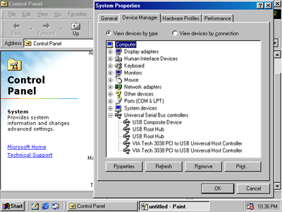

@group: all the usb2.0 cards I have tried have slowed down the system. But have worked.
Are there any usb 2.0 that don’t slow the system down?
I don’t have any usb 1.x cards to try. Do they slow the system down?
@beachboy, I have heard of people having success with the slow down issue by disabling it in device manager. Perhaps an option in leu of a non slowing card?

Doesn't a major slowdown kind of make sense here, though? If you look up the lists of bandwidths by interface type on Wikipedia, then consider the two following entries in particular:
  • PCI 32-bit/33 MHz : 1067 Mbit/s (133.33 MB/s)
  • USB 2.0 high speed: 480 Mbit/s (60 MB/s)
Which means that USB 2.0 takes up to almost half of the bandwidth available to the legacy PCI bus (32-bit 33MHz, what was commonly available in older consumer motherboards). And since the PCI bandwidth has to be shared with other stuff on the bus, notably the disk controllers , and in pre-AGP systems also the graphics card, yeah, that should lead to noticeable slowdowns.
Does the installation of the card by itself already cause a dramatic slowdown, before you even plug in anything? Or do you only notice this slowdown when, for instance, you have a an SSD in a USB 2.0 high speed enclosure hooked up to it, maxing out the USB 2.0 bandwidth?
I wonder if most (if not all?) USB 2.0 chipsets work in such a way that they always "claim" or "reserve" the full 480 Mbit/s from the PCI bus, even when the USB devices connected to the USB 2.0 controller don't necessary take up all that bandwidth, or when none are connected at all. I'm not knowledgeable enough to answer that question, but I'm sure others here are.

They slow down the system just by being installed. I’m not going benchmarks while copying files 🤣. :p that would make sense if that was the problem.
No, just by being installed they slow the system down.

One of my motherboards will periodically wreck its automatic BIOS configuration by running out of resources with a USB 2.0 card installed. This is an Intel 440BX board, Slot 1 Coppermine, nothing special, with Intel BIOS. There seems to be no "consistent" configuration. Sometimes it will just start screaming at boot about "resource conflicts" and the USB card won't function properly.
Sometimes it gets so bad that I need to reset the BIOS. I don't know what it's doing or why it has such a hard time, but these older boards seem to really dislike USB 2.0.
I haven't done extensive testing, but on this board at least, removing a USB drive after choosing to "safely remove" will almost always hard lock the system. This is with Windows ME, so there is no monkey patching like with Windows 98. It's just plain unstable.
The USB card is a known-good NEC controller with the latest NEC drivers for the chip. I tried other cards as well in this motherboard with the same result.

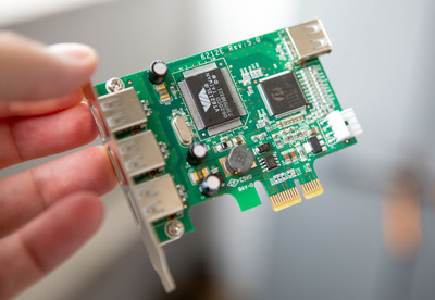

Reply 197 of 272, by OMORES
I did mentions this card before...
I would recommend form Startech the PCI-E to USB 2.0 card using the classic VIA 6212 chipset. This PCI-E card it's recognized in Windows 98 with default drivers, works also in Windows 95 OSR2. (tested)
I mean not everyday you can find a PCI-E hardware that works from Windows 95 to Windows 11.
