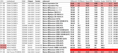

Reply 102 of 113, by Gona
AGP Matrox cards also has small differences is DOS. G200; G200A; G400 and G400 MAX AGP cards are the fastest and they has full the same performance.
G100; G450 and G550 AGP cards a bit slower and Parhelia 128MB retail AGP a bit more slower especially in Doom (12%).
It is interesting, but in same motherboard the G450 PCI versus AGP gives a bit mixed advantage: PCI better in PCPBench, AGP better in 3DBench and Doom, and Quake is the same. Also interesting that G450 PCI was better than G200 PCI on Intel VX, but G200 AGP is better than G450 AGP on VIA MVP3. It seems G450 and G550 are optimalised to Intel chipsets.
36.27 KiB
1190 views
Originally I want to test the Parhelia 128MB retail AGP in an ASUS P3V4X motherboard and PII 233 CPU but the card not start in it. Finally I test it in an AGP 8X board.

Reply 103 of 113, by feipoa
Curious. Does the MVP3 chipset generally show faster DOOM results, or is it just with the Millennium series? For examplel, if you used a TNT card on the 430VX vs. MVP3, would the MVP3 still show a bit faster results?
The results look fairly static in DOS. Perhaps doing a similar comparison in Direct3D and OpenGL would be more meaningful?
The Parhelia AGP has two variants - one is keyed for 2x/4x/8x while the other is 4x/8x only. Do you happen to have the Parhelia keyed for 2x?

There seems to be a lot to do with the bios timings in regards to ss7 performance. Ss7 usually has better memory performance also.
K6 3+ aiming for the stars thread talks about this.

Reply 105 of 113, by Gona
feipoa wrote on 2022-11-11, 03:55:
I have to correct my earlier statement: Also it seems VIA MVP3 is better in Doom, but Intel 430VX/HX/TX are better in all other. to this: It seems VIA MVP3 with AGP versions of the cards is better in Doom, but Intel 430VX/HX/TX (with PCI versions of the cards) are better in all other. With same PCI cards also the Intel 430VX/HX/TX are faster, only smaller the difference in Doom compared to the other benchmarks. I have benched best DOS performer cards and this small difference is common: between 1.59% to 2,52%. The only bit bigger difference the 2.84% is the G450 PCI, because Intel chipset optimalisation. I have something about this optimalisation:
"What features will not be supported for the combination of G450 PCI and non-Intel chipsets?
DVDmax and OpenGL will not be supported for the combination of G450 PCI and non-Intel chipsets.
Will bus-mastering ever be supported with the G450 PCI cards and non-Intel chipsets?
Matrox does not foresee much demand for PCI graphics products for systems with non-Intel chipsets"
(https://web.archive.org/web/20040622004143/ht … 450/pci_faq.cfm)
Here are my Doom results:
7.32 KiB
No downloads
Direct3D and OpenGL would be full different. For example nVidia AGP cards from Riva128 AGP to the GeForce3 Ti 500 has full the same DOS benchmark results (laters should be same or slower), but in Direct3D and OpenGL GF3 is much faster than Riva128. Also S3 Trio64 is faster in Doom than later S3 cards. It is interesting that in Doom the S3 Virge/GX a bit drop behind although Virge/GX is the only chip can fast enough for DOS Duke Nukem 3D is 1600x1200 (if the CPU is strong enough like P4). I have tested lot cards on the same P4 3GHz and Duke 3D was only playable on Virge/GX in this resulution.
But here Direct3D and OpenGL benchmarks are not interesting because we were wondering what is the fastest chipset for the Pentium 100 (and we were surprised that it is Intel 430VX/HX/TX not the SS7 chipsetted boards), and I would not play Direct3D or OpenGL game on a P100 machine.
This is the 2x/4x/8x version.
