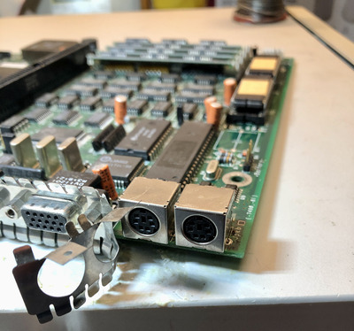

Fixing a sick Packard Bell today. It had both(!) PS/2 ports bad. I guess someone tripped over the cables and yanked on them pretty hard or something.
New ports installed and working!

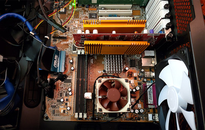

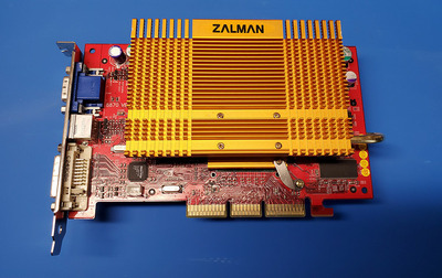

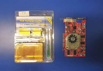

Had picked up a couple NOS Zalman fanless GPU heatsinks awhile back, so I decided to install one on my GeForce 4 Ti 4200. The stock fan was extremely loud, so anything to quiet it down would be a blessing.
This was the last noisy component in my Athlon 2000 / Windows 98 rig. With a combination of modern quiet fans, fanless cooling for the graphics card, and an SSD, this computer is now virtually silent.

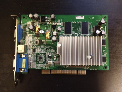

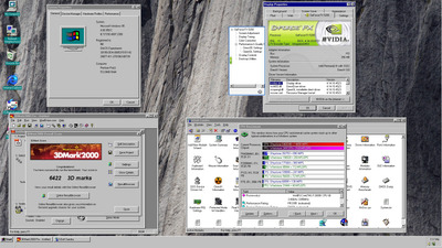

I bought this PCI GeForce FX 5200 (256MB, 128-bit bus) for my overkill Windows 95 build last week. While it isn't a great card for DX9, I found it the best (i.e. fastest) PCI video card that I've tried so far still fully compatible with Windows 95 and DirectX 8 (and below). I used the GeForce 45.23 drivers for Windows 9x because they were the last drivers that provided the Nvidia control panel within Windows 95.
I needed a PCI or PCI-E video card because I'm shooting for a fast single-core CPU as the primary driver for this build. Here are the specs:
- Gigabyte GA-P75-D3 (Intel B75)
- Intel Core i7-2600K (3.8GHz Boost Clock on a Single Core)
- 8GB G.Skill DDR3 1600MHz
- PNY GeForce FX 5200 PCI (256MB, 128-bit Bus)
- Sound Blaster Live! Value
- D-Link DFE 500-TX 10/100 Network Adapter
- Startech PCI-E 7-Port USB 1.1/2.0 Adapter
- Rosewill RC-212 SATA Adapter
- Generic 64GB SATA2 SSD
- 2x Generic DVD-RW Drives
- Windows 95 OSR 2.5
Windows 95 OSR 2.5 runs really well on this platform, and I haven't encountered any major compatibility issues with the FX 5200 so far. I can run MDK 2 at 1080p (16-bit color mode) with over 60 FPS, and Unreal Tournament runs well at 1080p in both DirectX and OpenGL modes. Jedi Knight 2 oddly won't run in 16-bit color mode (it crashes if I don't select 32-bit color), but it runs buttery smooth at 1280x1024 (32-bit color). It's also nice to see the fog effects in Thief 2. I got a score of 6422 in 3DMark 2000 with the FX 5200 which is nearly double the score I got with an overclocked Radeon 9000 PCI (64-bit bus).
The passive heatsink on the FX 5200 gets pretty hot, though. I think I need to invest in an active cooling kit for the card.
This has turned into a pretty sweet build, and it brings back a lot of memories from installing and using Windows 95 back in the day. This is the kind of hardware I wish I had back then.

The FX5200 in PCI is likely the better use case for it as that bus wont be able to push it to the point that its flaws come into play, I think we all know just how painful this card can be on an AGP bus. Its also more compatible than the 6200 PCI !

Yeah, I wish Nvidia had pushed backwards compatibility just a little farther. I can get my GeForce 6800 GS working with Windows 95, but it acts really weird in 3D applications (and no way to control its behavior).
Oh well, I guess driver development had to move on at some point.

Nvidia changed a lot between the 5000FX core and the 6000 series core which didn't help compatibility much, the drivers also changed and later drivers dont work as well as earlier drivers do.
Even with the older GF4 cards it helps to try a few different drivers versions when testing as the newer GF4 drivers can be slower than the older ones.

nice, though it looks like you've got sata ports on that MB, i'd opt to use those for sata hdd

Nice looking system. What is the board? Looks kind of Abitish, but I'm not sure. CPU and cooler?

You're correct, the board has a couple SATA ports. I do have a SATA SSD drive I'm using which I transplanted from another system. It's already hooked up an IDE-to-SATA adapter, I just didn't bother unhooking all that. But I probably should, since I suppose it would clean up the cables in the case.
stef80 wrote on 2022-09-06, 11:34:
Thank you! The board is an ASUS A7V600 running an Athlon XP 2000+.
For the CPU cooler, it's a combination of a Cooler Master heatsink with a Noctua NF-A6x25 FLX fan (60mm). Does the job and keeps the noise to a minimum.

for win 98, i find that a seagate 500gb platter sata hdd formatted to 137gb is good enough much snappier than ide etc

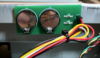

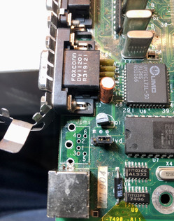

Made some dual CR2032 boards for my old motherboards with external battery header. I still feel better having the batteries off-board. (The diodes bring the voltage down to 4.8V. I feel more comfortable with a voltage around ~5V compared to 6V.)

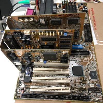

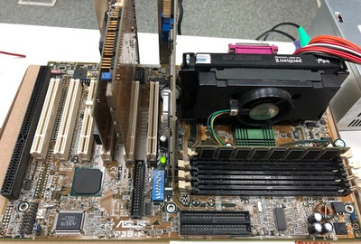

Just start to tune my Asus-mania project!
Asus P3B-F mobo
Asus V3000ZX 3D Eplorer video
Asus Maestro-1 3D Explorer sound
Asus Intel 100mbit ethernet
Asus (!) DIMM module (in Asus original gold pcb color)
Intel PentiumII with free freq and multiplier…

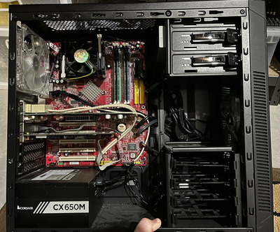

Today I started setting up my reverse sleeper, at least before I realized I was actually using all of my SATA SSDs. So instead I just have more airflow than 2003 actually needs.
I second that. I believe that old motherboards have been through enough and there is no need for further stress.

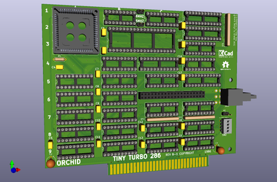

Finished up this board design. Just needs the PAL chip dumps..
