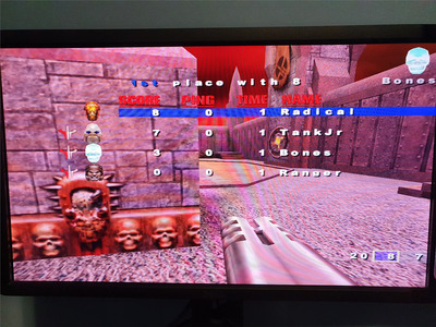

Installed Quake III with all maps, it runs great on the VV as expected... Will see how games will work once, i freeze the card remove the stock coolers, and install Titan copper coolers. And then will try max OC of the card, so far it is stable at 180MHz, will try 190 and 200MHz to see how far the card can go. But anyway i dont think i will use the card on 200Mhz, even if it can, as i dont want to brake one of the best collector`s parts, so 190MHz will be nice, but to change the coolers ofc.. I wonder other ppl that did replace the stock coolers or Voodoo V, how much did specially the Titan Coolers improve the cooling of the card. I think optimal cooling will be Zalman VF700, but i have only 1, so yeah i need second one in order to cool the second chip too.

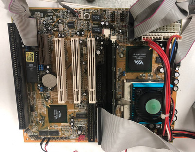

VIA MVP4 based motherboard setup/recovery/cleaning.
Nice office-board in my 1999/2000 history - Rollcage, Quake, Starcraft!

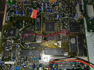

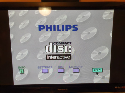

Last week I attempted to replace the battery in the Timekeeper chip on my Philips CD-I 210/25. It wasn't really bothering me, but thought I'd give it a go. I was being very careful, chiseling away at the chip whilst still soldered into the board and the inevitable happened - I slipped and hit the motherboard! Ended up severing 4 traces on the motherboard, my Philips CD-I was dead!!! Not easy traces to repair either as they are quite small and close together.
Fast forward to today, I suddenly felt confident and decided to have a go at running some jumper wires to bypass the 4 damaged traces. Bare in mind I've NEVER tried this before in my life and had only watched hours of YouTube videos on the subject, never attempting it myself.
I spent hours following the damaged traces either side, to find out where they all went and scratched off some of the solder mask either side of the breaks for continuity testing with my multimeter. 1 of the traces went directly to 1 of the chips. I fed the jumper wires through and then on the underside of the motherboard I scratched away a bit of the solder mask, applied some flux and then soldered the cables into place. For the 1 wire going to the chip, I decided to simply solder it onto the leg of the chip and add some hot glue to stop it flexing.
I also added some clear nail varnish to seal the damaged and exposed traces.
First power on and it lives again!
193.08 KiB
631 views
And a picture of my handy work, not the neatest job in the world, but it works. I'm quite pleased with myself for the first ever attempt at this kind of work!
368.46 KiB
631 views
I think I'll leave the timekeeper chip in it's present state, not going to tempt fate. 🤣

I always like these stories with a happy ending, good job!

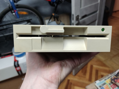

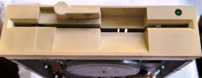

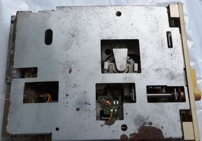

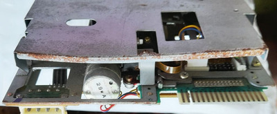

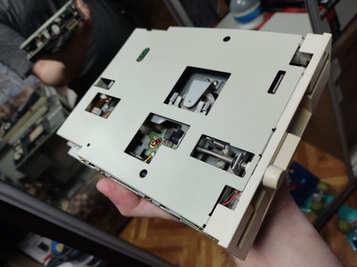

Bought this old floppy drive for less than $1. They are pretty rare and expensive in Ukraine now - can cost $30 and $40 being in same state, no guarantee to work.
I cleaned it, greased the motor spindle, removed the rust from the top cover (mostly damaged) and painted, retrobrighted the front panel. I tried a car wax on plastic parts, interesting, if it helps to protect from repeating yellowing.
Not the perfect restoration, that required full disassembly - that's elaborate and risky process. But much better than it was.
I cannot imagine retro system without floppy drive, hard drive and CRT display - they create that special feeling and mood. And 5.25 floppies are the most 'real' ones. I almost missed them, I had a pack of such floppies in childhood to store some games but my first PC already had a 3.5 inch drive.
What else... Washed boards for my next build, painted the case. Will finish my 386 build this weekend I hope.

Nice work! From the perspective of the faceplate, it looks almost brand new.

Thanks. Just found the same model, in much better shape - something like $55. Still requires brightening of the front panel (that adds very much to overall look as it's the only part we see tbh) and nobody knows if it works 😀
Need to take a box of floppies while they are available 😀

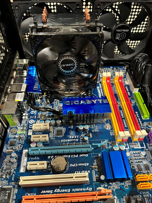

While building this Core2 XP x64 machine, the Socket 775 compatible cooler did not fit; peg holes didn't align, and the plastic mounting mechanism was too wide thanks to the surrounding heatsinks. A few minutes with a Dremel solved the problems.

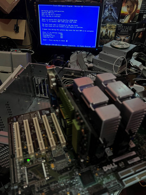

Next, this GX300 was not booting. Long story short, I pulled the motherboard out of the case, and it booted fine; there must have been a short or something. The BIOS update to A10 now makes it possible to add 256Mb-chip capacity RIMM modules. In keeping with its workstation roots, I upgraded:
CPU: PIII 733/133 x2 --> 1GHz/133 x2
RAM: 512MB --> 1024MB ECC
GPU: Nvidia TNT M64 16MB --> ELSA GLoria III (NVidia Quadro 2 Pro 64MB)

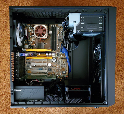

Transplanted my Windows 98 build into its new case, a Fractal Designs Focus G.
Next on the list is adding an Audigy 2 ZS alongside the current Diamond Monster MX300.
