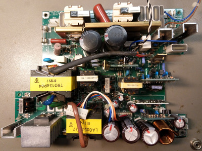

I have tried to repair this stupid Toshiba power supply. Main switching transistor was shorted, but replacing that didn't solve the actual problem. It's totally dead.
Power supply PWM controller is MB3759, same as TL494. It's build around 89-90, but has ATX style power-ON button. I think fault is in secondary power supply somewhere, but haven't found any other broken components yet. PS-ON pin voltage is zero. They have made fault tracing difficult with those daughterboards. There are some "hot" burned and brownish components, but I have measured those to be OK.

Sanity check your fuses, I've found one open circuit while not appearing blown before. Think it was mechanical shock detached it one end or something.

Fused were ok, but I found 5W wirewound 15R resistor with infinite resistance. It has functioned as a fuse.

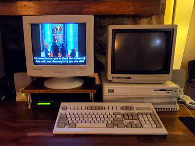

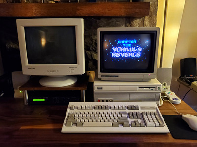

Finished working on my Tandy 1000 TL and set it up in the living room for some gaming.

Shponglefan wrote on 2023-01-23, 22:27:
Space Quest II and Eye of the Beholder
You treat yourself pretty 😀
Nice setup. It makes me feel 80's vibes!

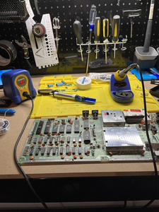

After getting my pi1541 up and running, I noticed that my C64 was screeching for a moment before booting. Few weeks later and here we are, with a pack of capacitors ordered and a bit too much lead-dust for anyone's safety.

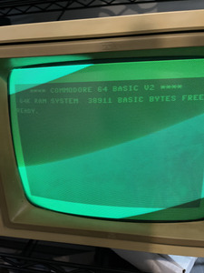

And, luckily, I didn't mess anything up, and no longer have the screech. Once my modern PSU comes in, I'll be free to track down ways to get this thing playing the music from PAL releases without them playing too fast.
1.51 MiB
860 views
And yes, the color works. My Apple Monitor II was just the closest and easiest to use.

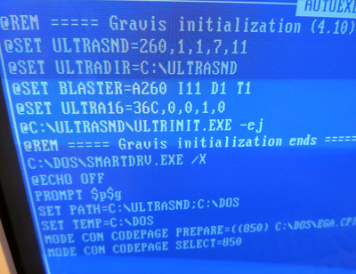

Finally got some sound out of the GUS MAX....
Now the fun really begins when I'm gonna add a SB16...

You probably want to make sure that your ULTRASND and BLASTER settings don't have overlapping base addresses, IRQs and DMA channels...
Edit: PS, you can get short audio passthrough cables, that way you can LINE OUT the GUS to LINE IN of the SB so that you don't have to mess around with switching speaker cables.

Thank you! Definitely happy with this setup so far.😁

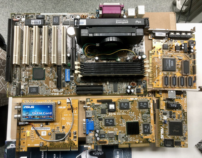

Asus-mania day.
M/B Asus P3B-F, Asus PC-66 Dimm 16Mb, Asus V3000 AGP videocard, Asus TV-FM 7134 PCI tuner, Asus PCI-AXP201 soundcard and Asus PCI 100mbit Ethernet card (Intel-based).
Pre-assemble, check and install Win98.

Nice haul of Asus parts. Any fun plans for them?

Yep! In search of Asus FK-series case, FireWire and SCSI cards to complete Asus-mania rig)))
it's good to have a workspace set up like this
that's another few months/years on your c64. it's the willingness and skill to do this kind of maintenance that keeps those machines going.
are you tempted to keep multiples of commonly used components to 'future proof' maintenance?
If I had parts available locally I would. Currently, though, my SID is missing a single audio channel.

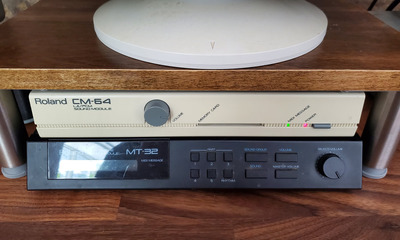

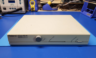

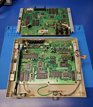

Fixed this Roland CM-64 today.
It was only outputting sound on one channel. Took it apart and didn't see anything immediately obviously wrong.
I cleaned the audio connectors with some DeoxIT and reflowed the solder joints on them for good measure. That appears to have done the trick as it now is working perfectly.
