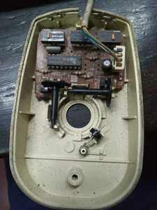

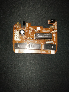

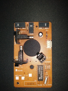

Today, I repaired my childhood life's 1st and 2nd Mouses (Serial) that came with a XT and 386 System.
Genius Serial Mouse.
I remember that both of them abandoned due to click issues and upgraded technology of PS2 and later Optical.
But since they were my 1st Mouse bought by my late father, I always kept them....
Today, I cleaned them and replaced all the switches.
Buttons are now working fine; movement is also decent enough.
P.S. I am too afraid of doing the 'Retro Bright', no experience....

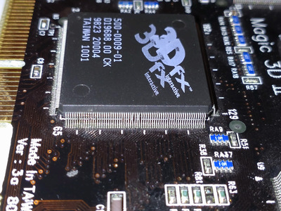

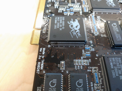

Easy fix for this Voodoo2, and a reminder to pay good attention to the chips' legs.
At the moment they short, the card came up in the BIOS device list as Unknown PCI card and even got an IRQ assigned. As some of you already know, Voodoo (2) cards don't need an IRQ to work.
Before and after pics included.

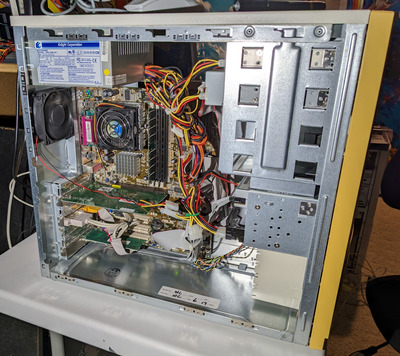

Yesterday's retro fun was to check out this Socket A system that I purchased for $20US at a local thrift store.
Enlight mid-tower case, DVD and CD burners, 3.5-inch floppy drive
Asus A7V333 mb (caps all look good), GeForce2 MX400 AGP, 512Mb DDR, Athlon XP 1800+, WD 120Gb hd, 3com network card.
After replacing the CMOS battery and refreshing the CPU heatsink compound, I was pleasantly surprised to have it boot right up into Windows XP SP2.
After writing down some hardware info and playing a game of Space Cadet 3D pinball, I rebooted with a DBAN cd and let it autonuke the hard drive.
(It was still full of the original owner's personal files.)
I already have a better XP machine, so I think that I'll put Windows 98 on this one. Perhaps put a sound card and better video card in it.

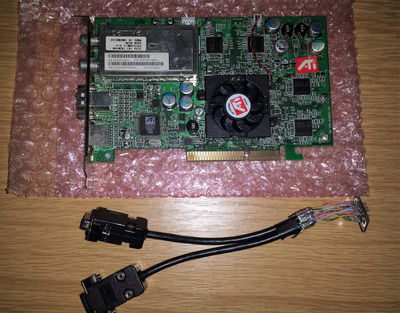

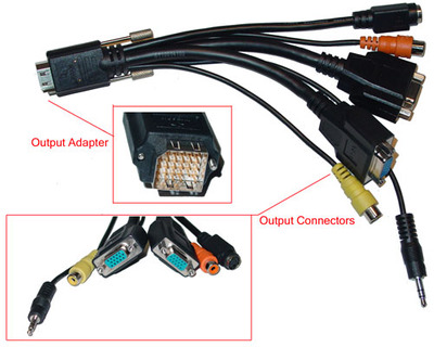

Made a display out cable for a AiW 9600Pro that came without that super special all-in-one-with-non-standard-connector-cable.
It's not finished yet (still needs a case), but I'm finally able to connect up to two monitors to get at least any picture out of that card. Not sure if it's worth the effort but I couldn't dispose an otherwise known good card.
Unfortunately I couldn't get this to work, yet, with Win XP on my K7SEM testboard with any driver I tested (Catalyst 6.2, 6.7, 10.2 and 10.4).
Not sure if it's something board/chipset related that prevents this combination to work together. As soon as the system is booted to desktop it stops responding after some secs.
Standard Windows VGA driver seems to be working ok though.
I've read about some AGP incompatibilities of this board but due to my lack of experience with Socket A as well as older Radeons it is just try and error for me.
Maybe there are some suggestions around...

Not really. The AiW9600Pro uses a separate box for inputs (which mine is also missing). But I'd be glad to have a usable output at first.
The second picture in my post before shows only the cable with the outputs.
Besides that I had a Rage Pro 128 back then which also had video inputs and that worked without any hassle for capturing.

Awesome work, there's quite a few of these cards around cheap because the cables are unobtanium.
K7SEM tho... not a great board as you might have figured by now, all of the ones I've seen have had advanced cap rot. Even when those are replaced I think it might be short on AGP power, since it's a cheap design that was done a couple of years before 9x00 series. There's gonna be limited historical experience to guide you I fear, the kind of systems that got K7SEM got MX400s or other low spec cards, probably one of those and a spitfire core duron would be something of a classic combo on it. So not sure how much here is gonna be fighting the board vs fighting the GPU.
Anyway, looking forward to when you post the cable pinout and share any details about where you can get that goofy connector from.

ATi had several cards with that connector, even in the same series, think there was a 9600XL or something, BUT they all appeared to use it differently, on an 8500 AIW it seemed to be input and composite only, then in 9600s it was outputs also, both VGA and DVI versions, then later I think they went back to conventional bracket mounted primary video connector and input/output dongle use. So I am not very sure that those cables work between models at all. Possibly there are enough pinis on the connector that all connections rationalise to constant pin uses, but IDK, it's one of those standards that ATI never seem to have shared if so.
