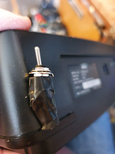

Today I perfomed a quick and easily reversible modification to my Neo Geo CD console.
I took 2 pieces of jumper wire, soldered a toggle switch onto 1 end and then soldered the other end of the wires to the region selection jumper pad inside the console. Now at the flick of a switch, I can select the console's region between Japan & USA. USA for English language on the games that don't offer it as an option and Japan for full uncensored glory - ie. full red blood in fighting games & the likes of Metal Slug and other unadulterated graphics in several games.
I didn't want to drill a hole in the case, as I want this 100% reversible, so hot glue and electrical tape bodge job it is -

Not the prettiest looking thing, but it's hidden away at the back. It does the job, so will suffice!

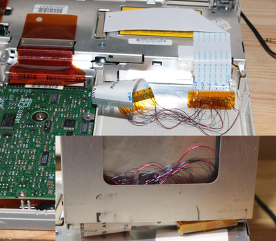

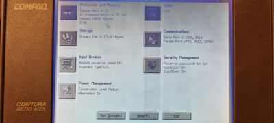

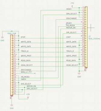

A long time ago I plugged my Citizen VIDA-15B floppy drive from the Compaq LTE Lite 4/25E into a regular 26pin floppy cable and burned out the drive. That sucked.
So of course I had to convert my Compaq LTE Lite 4/25E to a direct drive floppy! The pinout is basically the same as the Compaq SLT's Citizen OSDA-53B pinout listed here.
I had to get familiar with what connection does what and verify all of the pinout which is basically the same:
49 KiB
2248 views

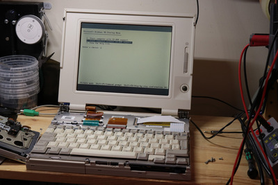

Fitting a Teac FD05-HG in the bay works really well - 3 of the 4 screw holes match up with regular floppy drives so the drive sits properly without major modification. I had to trim down the eject peg so I didn't have to trim the case.
517.73 KiB
2248 views

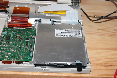

This took a while and after getting it all together, the drive didn't work? It didn't seem to do anything and I spent ages checking I had the lines right with the oscilloscope (shoulda used logic analyser but scope is easier for these quick checks). The original Citizen VIDA-15B drive just made the computer upset since I burned out some components on it plugging it into a flat cable connector that put 5v into its sensors and things, so that was rather useless for reference.
I also spent a really long time figuring out how the connections are done on the mainboard - some of them are exposed on the docking connector which really helped, but after it didn't work I was second guessing everything and was about to go back to the drawing board.
It turned out I didn't have any pins wrong, but the flat flex cable connector I'd wired it up for had the connector pins on the other side than what I soldered it up for, argh. These are all just salvaged from dead drives so it's tough to know what's what.
1.24 MiB
2248 views

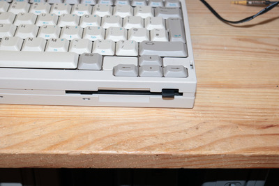

Once it was resoldered the drive has just worked! Considering the trouble that Citizen belted floppy drives have given me, a direct drive floppy on this LTE Lite is awesome. It predates PCMCIA so getting files on and off of it is otherwise a hassle.
Now the prototype works I can get some adapter PCBs made - it also means that a Gotek PCB could go in potentially.

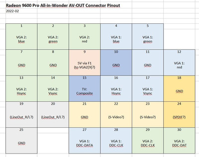

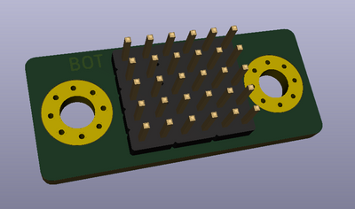

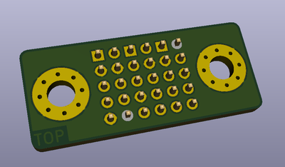

A bit late a reply but I had to dig out my notes on that at first.
Here's what I've got so far.
The pinout is correct for the two VGA ports. All others are a bit of a guess so far basing on my measurements on the card as I could not test them any further yet.
Please keep in mind that this holds true only for the AiW 9600 Pro. For other cards using the same connector I can't give any guarantee whether the same pinout fits.
I couldn't find a supplier for the original connector, altogether I think this can't be bought at all but was a custom part made just for ATi. The manufacturer should be "Wieson" as far as I could find out but not sure about that any more.
That's why I've made a small PCB for getting all those tiny wires fixed together (gerbers attached).
At first I tried to use some 1.27mm/50mil pin headers for contacting to the graphics card but eventually I used some crimp contacts I ordered from Aliexpress. They are long enough to reach trough the PCB and make good contact in the connector of the AiW. Mounting is still some fiddling but in the end it will do the job. Would have to dig out the link for the contacts if there's any interest.

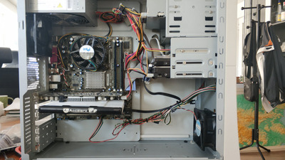

Almost finished a Win98 overkill machine with P4 530J, Intel Intel D865GSA MB and GeForce FX 5900XT . Case, CD and FDD are retrobrited, all metal parts washed.

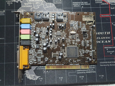

Installed a SB Live! CT4830 in my Socket 370 PC.
1.98 MiB
2103 views

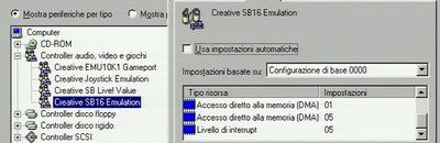

Tested different drivers, VXD and WDM ones. The best one were the VXD in the Audigy 2 ZS package downloaded from Phil's Computer website.
Installed DOS drivers too and SB16 emulation works flawlessly in both real MS-DOS and Windows MS-DOS mode. I just had to change in BIOS the IRQ assigned to the real PCI card because it was interfering the emulated SB16 one.

That is awesome thank you very much. Ah, roll your own connector, I had ideas before of getting single pin contacts, putting them all in place then casting a plug in place around them with hot glue or epoxy. Nice work on the PCB but I might be trying it that way still. 95% sure I've got the same card as you. I am however going to compare this pinout with one for a later AIW that's posted on that pinout site, just to see if it has common elements, that one has DVI outs, and also see if the comps line up with a video only cable I have for a 8500 all in wonder.
Thanks again
Edit: Other known pinout X1xxx series AIW?? https://pinoutguide.com/Audio-Video-Hardware/ … e5_pinout.shtml
