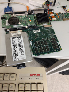

The Elite 4/75cx has been disassembled. What happens if I remove one VRAM chip, will it boot with only 256kB video memory? One way to find out.
Fun fact. Depending on your model, this laptop can come with 512KB or 1MB of video memory.

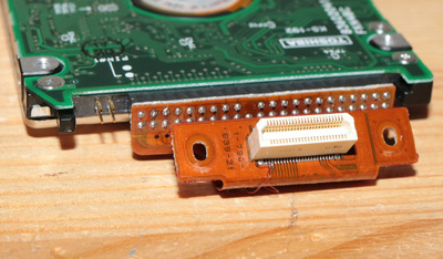

Today's my birthday but I'm more stoked about my most recent fix. I got a VAIO F801 laptop which is an AMD K6-2+ equipped budget desktop replacement from around 2000-ish with Windows Millenium edition. This one was being sold so cheap I was worried that it was going to just get put into ewaste so I went ahead and got it even though I don't particularly need it - the audio and video aspects of this laptop aren't that special, but it's built like a tank and looks cool.
It didn't come with a hard drive or the special caddy connector but in my stash I had the right one, since I bought another dead F801 in the past.
Putting it together it would sort of detect a drive or CF card but FDISK showed "No Fixed Disks Present" and it would show the wrong name - "CF CARD" became "AF CARD" and TOSHIBA MK1016GAP became "TOQHIBA MK1016EAP". I like clues like that, I think I recall Adrian doing something similar in one of his repair videos to work out where the problem was.
Looking up the ASCII > binary table, it was changing G into E and S into Q:
Q 081 01010001
S 083 01010011
E 069 01000101
G 071 01000111
The difference there is the seventh bit, so I started probing around the HDD caddy connector to see if all the data pins were present. It turned out that the seventh (DD6) and ninth (DD8) data bits were missing - that makes sense. Maybe the DD8 being missing isn't possible to spot this way because the ASCII table doesn't use such a high number (>127).
They were both broken on the flex cable where it got flexed wrong so I patched them with some enamel wire ~0.1mm:
891.33 KiB
835 views
Did all that without much magnification and it turned out pretty well. Now the drives detect properly and I can start installing OS soon. Of course, it's too old to read a 10gb drive over the 8.4gb limit so I probably need to swap out the drive again.
In the process I put thermal paste on the CPU since it never apparently had any, just one of those aluminium sheet things - that's backfired terribly since the thermal sensor is on the heatsink and now the heatsink gets hotter than stock because it's actually doing its job. It's running cooler but the fan never stops now, ah.

Happy birthday!
Great job!
I had the same issue, putting thermal paste and all goes haywire because it's actually working 😀
I had it recently with a Duron mobile and now it's impossible to hold it on my legs... unlaptopped!

Bravo! I don't think I could have done this without magnification. That's some fine work.

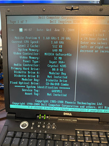

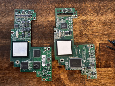

I upgraded the GPU in my Inspiron 8200 from the 32 MB GeForce2 Go to a 32 MB GeForce 440 Go. I was hoping to find a 64 MB card, but the 32 MB was extremely cheap and available. 3D Mark 2001 SE score doubled. Now I just need a Radeon 9000 card to complete the set for this model.

The Compaq LTE Elite 4/75cx sprung to life. I just reassembled it, so I think it was a loose contact.
Unfortunately I wrecked the front LED flat cable. 🙁

That's not good. Out of my two units, only one has a working LCD cable. The one that failed was from my childhood, and wa failing even back around 1995 or so. The screen would get messed up and I had to jerk the screen open and shut for it to work right.
Let us know if you can find a suitable replacement.

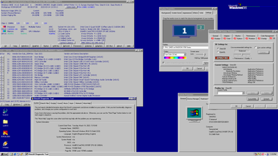

Just installed Windows 98SE on a Intel 9th gen platform...

That's pretty cool! Did you patch something to make only 512 megs visible to the OS? I don't expect ddr3 to exist in that size?
[Edit] DDR4, I guess

After the first restart -> edit C:\windows\system.ini -> under [386enh] insert this line MaxPhysPage=20000 This will limit ram to 512MB. Usually I use MaxPhysPage=10000 ~256MB.
This move was enough for most hardware <2018. The problem is that - with newer configurations - after this step you enter into "Windows protection error" territory - which is not easy to troubleshoot. In fact I don't know any Windows 98 installation on newer Intel hardware than this. Even for gen 9 I didn't find any video when is used real hardware. (there are tons with emulation)
