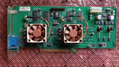

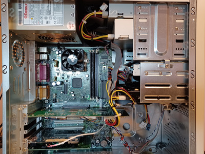

Finally finished my "Year2k" build based on PIII Coppermine 1GHz, Voodoo 5 and Aureal Vortex 2:
1.92 MiB
1295 views
1.84 MiB
1295 views
Very silent it is 😉.
It's based on a PC I had in 2001, with some changes:
* GeForce2MX -> 3dfx V5 5500
* SB Live! -> Aureal SQ2500
Case is actually the same.

There is no need to compromise. A PCI Sound Blaster can happily live alongside an Aureal Vortex. You just need to feed the line-out of one into the line-in of the other.
Getting the drivers configured is a bit tricky, though. Make sure to disable legacy sound emulation for one of them in Device Manager, otherwise they will conflict. Also install the Aureal drivers last or backup and restore the a3d.dll that is installed. Creative's version has bugs, and you need the Aureal one to work with the other card anyways.

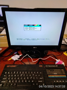

It lives. 😀
Had to glue the case back together in a number of places, add a composite out mod and a PAL/NTSC converter, and also build a US-compatible power supply.
The cassette player/recorder is still busted.
But the "computer" part works fine.

Good work!
The cassette deck will probably need a new belt, I had to do that on mine several years ago and was pretty much the only thing wrong with it. I hardly ever use cassettes though, a DivMMC expansion makes life much easier all around.

It's more than a belt; several of the buttons don't work properly, either can't be pressed down or when pressed don't click in place and stay down (the "play" button does that), so there's more to it.
It's not critical, I have a Interface 1bis to use with it https://sites.google.com/site/interface1bis/
and a TZXduino.

BTW I've used several "broke" cassette boomboxes as amps with merely a cassette/aux adapter, they don't need to turn, stop, eject well or anything else, all you need is some play mechanism function to get the head in place, even if you have to wedge the button down. So, it's possible you might get it "working" with one of those, with the 3.5mm plugged into another tape deck, MP3 player, winCE handheld (They play wav well) or laptop or desktop.

It's not the computer keyboard. That works fine. It's the controls of the mechanism of the tape deck, you see those at the bottom right of the picture separate from the keyboard.
There's something that mechanically stops them from operating correctly. Probably some part broken inside.
I think this machine had some sort of mechanical shock applied to it at one point. All of the standoffs that hold the 2 halves of the case together were broken and the bottom part of the case was cracked. That may have damaged the mechanism of the tape deck as well.
At least the PCB was intact and it works correctly. And the keyboard, which would be a pain to replace.
(BTW the PCB is actually +2B rev.1 not +2A; it's part number Z70833 - in theory I could remove the tape mechanism altogether and replace it with an original disk unit, and it would work seamlessly)
