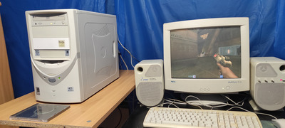

Finished rebuilding an car boot sale build I had gotten some time ago.
20230422_203851-jpg.292680
20230422_203900-jpg.292681
20230422_203910-jpg.292682
20230422_203919-jpg.292683
20230422_203929-jpg.292684
Specs:
ASUS A8N SLI
Athlon 64 3200+ Venice
4x512MB (2x Kingmax + 2x Sycron) DDR400/PC3200
XpertVision Geforce 9400GT 1GB DDR2
Spire Jewel SP-ATX-420WTN-PFC 420W PSU
WD AV 160GB SATA HDD 7200RPM
Pioneer slot-loading DVDROM
ASUS DRW-1814BL DVDRW
Sound Blaster Audigy 1394 PCI soundcard
Thermaltake Silent Boost K8 cooler
Techsolo TC10-SR case w/ new plexiglass panel installed
XP SP3

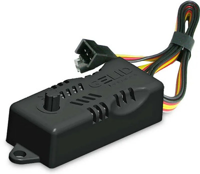

You can get a fan controller with a little knob on it and adjust it to spin as quietly as you want. I bought a bunch of these years ago to adjust down fans that run louder than I would like, and tape them to the inside of the case.

I can't seem to find any of these cheap enough (and neat-looking enough) to warrant buying a bunch to use for retro systems. I found some that are just a PCB with SMD components and a knob on the end for around $30 shipped for 10, which isn't bad... but they don't really say how they work, and if turning them down too far drops the voltage below 5v it could still make the fans not spin up. I think since they are PWM that wouldn't be an issue but I can't say for sure.
Also looks like they don't have a power connector so I'd have to add one myself.
https://www.ebay.com/itm/195650849909
If they were just a little bit more complete it would be really nice. I don't think I'd be able to sell a motherboard + CPU + fan combo with one of these in case the person left the PCB dangling unprotected and it shorted out.

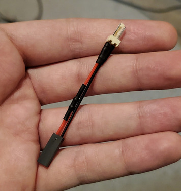

For only a few pennies, you can customize the voltage to a fan with a resistor and some heat shrink. The downside is that it requires a much larger investment into a soldering iron before you can even begin. I've done this a few times where I ended a small fan speed adjustment within a confined space.

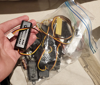

Here is a photo of the fan speed controllers that I'd bought in quantity years ago. I tried to do a search for you but couldn't find these anywhere. The cheapest I saw is similar but very expensive at about $5 + shipping, which I think is a lot for a fan controller.
1.1 MiB
481 views
These used to be so ubiquitous. I'm very surprised.

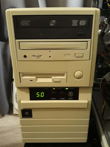

Finally replaced the case for my Pentium II build.
The old one was falling apart 😁
