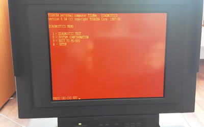

LE. I did some testing on T3100e , tryed to install (copy) Wolf3D CGA but had no luck in runing the game. (worked on that 2h)
