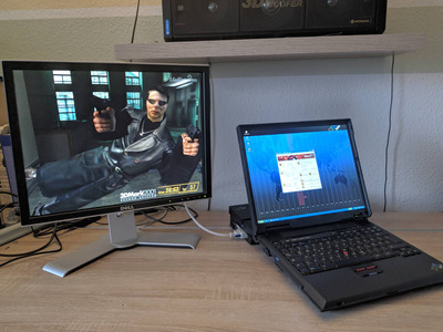

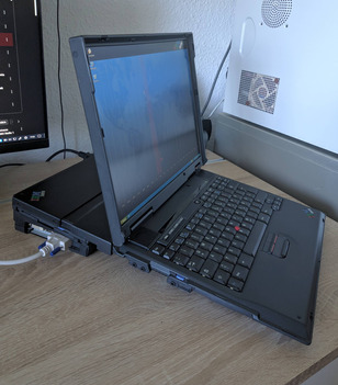

Today I equipped my ThinkPad A22p with the best docking station there is - the IBM Thinkpad Dock II (Type 2877).
The dock has one PCI slot for expanding the capabilities of this great machine. I put a Radeon 9250SE in it. Windows XP recognized it without a problem and it's a massive upgrade to the integrated Rage 128.
Windows 98SE crashes with a blue screen - I'll probably have to reinstall it so it can recognize the hardware properly.
In the future I'll probably puta 3Dfx Voodoo II in it so I can play some nice DOS and Win9x classics with the best graphics.
I definitely need a bigger table, though...

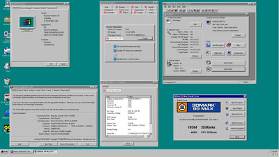

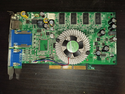

I've spent the last few days putting my latest acquisition through its paces. I bought a MEDION Radeon 9600 TX (essentially a factory over-clocked 9500 Pro) for a Windows 95 retro rocket. I have to say that I'm pretty happy with it.
I only found one Catalyst driver package that works properly with Windows 95 (both retail and OSR2). I had to modify the ATI Catalyst Suite 3.0 with the correct PCI ID for the card and updated screen modes for my 1080p monitor. It works great in Windows 95 with full DX8 and OpenGL support for all of the programs I've tested so far.
The ATI control panel options work too. This version of the control panel just doesn't offer as many configuration options as later versions, though.
The only issue I encountered is several helper programs in this driver package fail at boot up with user32.dll errors. They don't affect driver performance that I can tell, but this issue does prevent the ATI tray program from running (not a big deal to me). I just removed the .exe calls in the registry to keep the programs from starting at boot time.

Do you need to plug in the power connector that the card has for it to work well? I've got a similar Medion Radeon 9800XL card and that's got the same power connecter in the upper left and I suppose it probably does, but yours still has the sticker on there and is working. I wonder if the external power is more for boards that have poor AGP power implementation?
Also, it might be worth taking off the heatsink to see what the thermal paste is like or at least check the thermals. Mine has the same fan and it was practically welded onto the ATI R350 core, it uses a yellow thermal pad which was making good contact but I do wonder if it would have worked well. I've read that this cooler (same as your 9600) is a bit inadequate for a 9800 but I don't have another one that would fit. (BTW if you do try to pull the cooler off be careful, I heated it up with a hairdryer then twisted and it eventually popped off cleanly)

It's almost the fastest card possible for Windows 95 Retail. I figure a Radeon 9700 would be about 10% faster and the Radeon 9700 Pro would be about 25% faster. I paid a fraction of the cost of a 9700 or 9700 Pro for this card including overseas shipping, so I think I got a good value.
I don't have a GeForce Ti 4600 to test with Windows 95, but it would also be faster if it worked. I have tested a GeForce FX 5200 with Windows 95, but it doesn't work properly with OSR2 and it didn't work at all with the Retail version of Win95. I think the FX series drivers are just too new for Windows 95.
The sticker on the power connector says it's for mainboards that don't provide power. I gave it a try on my Asus P5PE-VM without supplemental power, and it seems to work just fine.
The GPU doesn't seem to get too hot. I don't plan to stress it with hours of gameplay (this is just a fun project), but the heatsink didn't feel very warm after I ran some benchmarks. I don't think I'll attempt to remove and clean the heatsink.

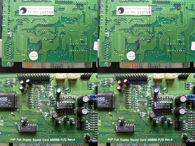

A very nasty looking ESS AudioDrive ES1868F. Lots of dirt and corrosion, but I don't see flat out broken traces or missing components and it was essentially free.

After a little bit of scrubbing I found a burnt trace coming from the ISA slot straight up to the wavetable header. Burnt traces are never a good sign, but if that's all there is to it, then it shouldn't cause any problem as long as a wavetable isn't connected and also it should be an easy fix.

I have no idea how that may have burnt. I misaligned and inversely plugged in wavetable headers before and never managed to burn anything before. Please check C25 for a short.. But I have a feeling they plugged in something other than a wavetable onto that header - the header itself looks a bit melted in fact..

Nah, the wavetable header is alright. It was still a little wet after the wash. C56, the one between the wavetable pin in question and the ground also seems to be fine (at least not shorted). Will check C25 and C26 when I get home. This is sadly bad news. If something inappropriate was connected to the card, it increases the risk of serious damage.

That is probably a power rail from the ISA bus leading to the wavetable header through some filtering caps, so if that rail got shorted elsewhere and there was a current surge all of a sudden.. well you know..
I wouldn't try that card out on an important motherboard for sure.
