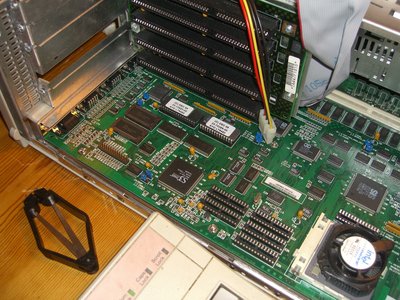

Im upgrading my new Digital Venturis 466 Socket-3 system a bit.
As the system came without a HDD i started off with finding a suitable HDD, this was yesterday. I choose a more or less new Quantum Trailblazer 840AT (840MB) drive as the BIOS while detecting larger drives correctly diddnt seem to save the parameters the next post with anything larger than ~1GB. The largest disk the DEC Venturis 486 line was sold with back in 1993 - 1995 was 840MB so I thought I would play it safe. I precopied the Windows 95 installation files to the disk to avoid issues with the SCSI CDROM drive connected to the SB16 SCSI. Everything went smoothly, I installed Windows and all hardware was detected installed and working without me having to tinker with anything.
Everything went smoothly until I installed Microsoft Encarta 97 that is. The 3x NEC SCSI drive seemed to read all discs perfectly, even almost 20 year old CDR discs but it had a hard time reading a brand new (but old) Encarta 97 disc. In the end the system hard locked while reading media from the disc and the next reboot ScanDisk found a single bad sector on the HDD while doing a surface scan. A few reboots later the HDD had alot more damaged sectors and it is more or less trash now.

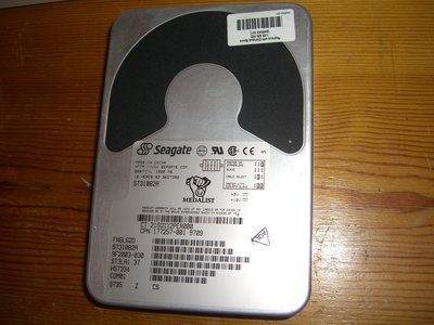

I replaced the Quantum HDD with a Seagate Medalist ST31082A disk and I replaced the NEC 3x SCSI CD with a noname IDE CD-RW drive, I was going to replace the SB16 SCSI with an AWE card anyway. I also installed 1 more megabyte of video memory. I tried to upgrade the memory to 36MB (16+16+4) but even if the system accepted the 16MB 70ns FPM module I installed the system wasnt 100% stable with it so Im back to the 4MB + 16MB the system came with. I will try some other sticks later.
The Seagate Medalist ST31082A 1080MB HDD.

The upgraded video memory.

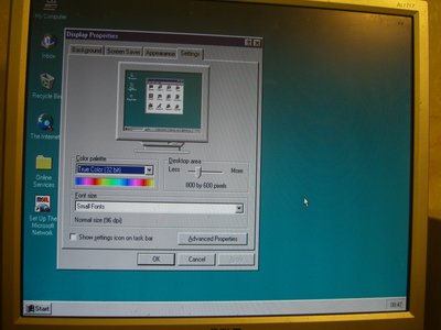

What the upgraded video memory is good for. (Its the dirty old LCD monitors crappy scaling that makes the image quality look bad)

I've never noticed it before, but I find it interesting that the desktop preview in the properties window shows the local network icon. I wouldn't find it out of the ordinary on Windows 98, but Windows 95 (that's what it looks like) it is intriging!
