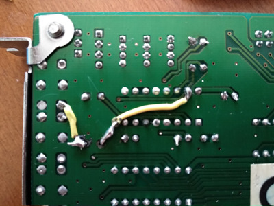

I know what its like to work with elcheapo parts. That beating sad the if the cards PBC was not damaged or the pad defective then the pad should have not came off unless if you applied to much heat or scarped the PCB/pad.
How much heat is too much?
400 degrees is definitely too hot if that's in Celsius. I'm not going to be as rude as DerSammler, but I do agree that the torn pads weren't completely the board's fault if you were using that much heat. I often use between 295C and 325C for PCBs with leaded solder, to overcome heat dissipation, and that might already be a bit much. Also, the patch wires aren't particularly pretty, you want to strip the part of the wire you want to solder first, twist the wires together, and tin it, as it looks like you might have just put the wire where you wanted it, then just molten off the insulation while soldering it on. The result is the ugly molten insulation, and loose pieces of copper wire sticking out. An ALS100 is nothing valuable, but maybe practicing some more before getting to more valuable hardware would be a good idea. We all have to start off somewhere, you don't want to see my first attempts!
Reply 15401 of 24451, by TechieDude
Daniël Oosterhuis wrote on 2020-05-19, 13:28:
Shit, and I used it at 399C. That explains it... As for the patch wires, I DID in fact strip them, but the insulation melted anyway. Also, they're aluminium wires. Next time I work on the card, I'll replace them with copper ones and I'll keep in mind to twist them and tin them, so it will definitely look better. It really isn't my first soldering attempt though. I've worked on motherboards and graphics cards (much newer too) with no issues at 399C, so I really was surprised with what happened with the ALS100, and thought it was the cheap-ass card, but now I know better. Thank you for your feedback.

Redid the patch wires on my ALS100. This time following Daniël Oosterhuis' advice, I used copper wires instead, and properly trimmed, twisted and tinned them. I also lowered the temperature to 325C. Still looks a bit charred and molten, but it's an improvement.
975.24 KiB
854 views
As for the sound, it sounds slightly better than before recapping, (not surprising considering one of the old caps had started leaking) but it still sounds a bit muffled and noisy. I wonder, what else can be done to improve the sound on it? Other than just printing a high quality board and installing the sound chipset there. 😀

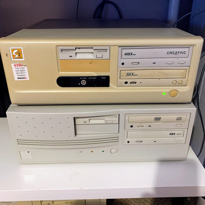

Tonight I finished the build on my dx4 100 system.
ga-486vs
amd dx4 100
16mb ram.
Aztech Sound Galaxy NX Stereo pro.
VLB I/O controller that I repaired from this thread: Re: Bought these (retro) hardware today
Cirrus Logic CLVGA542XVL/H VLB VGA
1gb CF.
The top CDRom is broken and just for show. I dont have any plates to blank off the gap.
Finished the build underneath it on friday
Jetway 994AN-L
P3 850 @ 952mhz
512mb ram
Voodoo 3 3000 @ 180mhz
Soundblaster AWE32
16gb CF

TechieDude wrote on 2020-05-19, 13:48:
You may actually have tinned copper wires, not aluminum. You can find that out by scraping one of the ends with a knife, the copper's specific color should appear. Either way, both of them are shit and I avoid them as much as possible. I always use pure copper wires.
As for the bodge job, as long as it makes good contact between the points and it doesn't touch other metal things nearby, I consider it a success (having done such job myself on other stuff I own). It's not like you're fixing rockets, it's just a cheap sound card.
Unless you are dealing with thick power rails, you don't usually need 400.C on your soldering station. You can get around this by adding fresh leaded solder to the parts in question, it will lower the melting point of the solder.

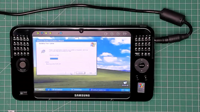

Today (and the last few days) I have mainly been messing about with my Samsung UMPC:
563.61 KiB
672 views
Now that I have the Tablet Edition of Windows XP on it, the plan is to put FUSE on it and relive my youth by playing some old ZX Spectrum games on it! It's about the same size as the Nintendo Switch and the battery still holds a couple of hours of charge so perfect for handheld gaming, assuming I can get on with the keyboard that is!
If anyone's interested, Ive even done a quick YouTube video on using the restore disc which was 'interesting' as despite me selecting English UK during the setup, it ended up being in Russian so I spent nearly and hour trying to work out how to change it to English UK! I'm assuming I must be able to edit the answer file within the ISO I got from the Internet Archive and change the language settings from Russian to UK - just need time to look in to that!
https://www.youtube.com/watch?v=TRbTFJp0m-M
