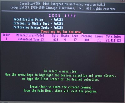

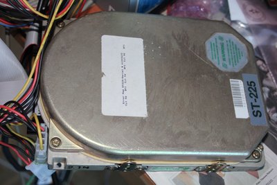

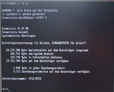

Reply 10121 of 27595, by Predator99
oeuvre wrote:
How does it sound?
Annoying loud 🤣 🤣 🤣
The Idle-Sound is that loud that you barely can hear the heads moving. Thats why I was thinking its dead at the beginning...but I put my finger on the stepper motor and realized its moving 😎

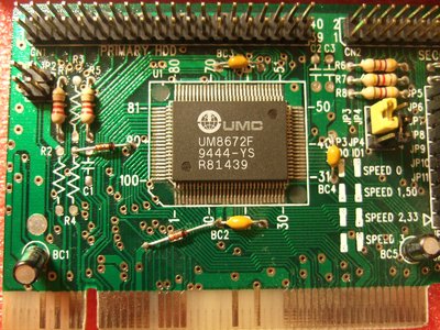

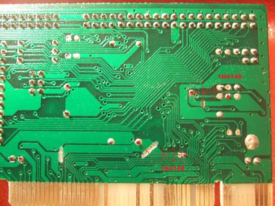

I've modified my MIO VLB card model TK8237 chipset UMC UM8672F.
The IDE VESA controller didn't work properly with my 3.3V CPUs AMD Am486DX4-100 and Am5x86-P75. It just detected a hard drive (volume and geometry) but MS-DOS wasn't booted (the system hung). Altough it maybe could work with 5V 486 CPUs I haven't got such models. In Internet I saw photographs of the same controller but with a factory mod. So I decided to reproduce. The mod has really helped!
The mod is easy - just 3 scratches and 2 diodes 1N4148 (DIP). The scratches have been done with dremel. They prevent 5V power supply to direct into the chip. The diodes drop voltage to 4.4V.
Before:
multikontroller-fdd-hdd-com-game-lpt-vesa-vlb-1.jpgMIO-UM8672-F-FRONT-BEFORE.jpgMIO-UM8672-F-REAR-BEFORE.jpg
After:

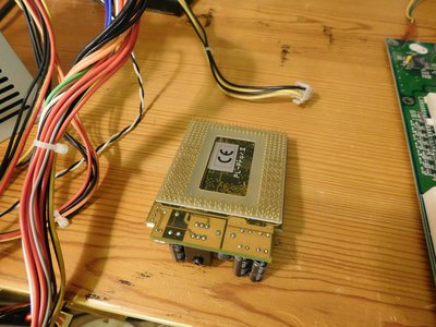

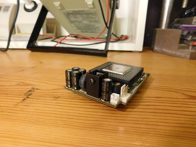

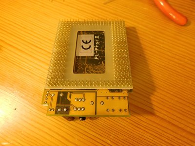

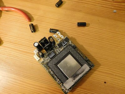

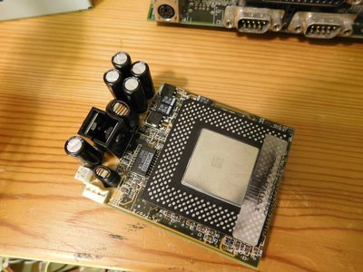

I have had a very frustrating evening!
I have recapped the Socket 8 adapter I bought from Ebay,
The adapter from Ebay managed to post 3 or 4 times out of perhaps 200 tries in a motherboard that is known to work with an identical adapter. I also retested that working other adapter a few times during troubleshooting, it never failed to post once.
I poked around with my multimeter and most of the times the mosfets would output too low voltages, once in a blue moon the voltage was enough for a successfull post. The blue moons became rarer with time and I finally gave up. One cap on the adapter was clearly bloated, one was looking a bit suspicious and the other 3 while looking fine were probably bad aswell I reasoned. NKCON caps are known to be shit.
I decided to not return the expensive adapter as they are rare but to do a full recap. Because the adapter had posted a few times I reasoned it was not beyond saving and would work better after a recap. Today I did the recap.
1.14 MiB
1413 views
I started with the bloated cap. After replacing it I tested the adapter and it posted at the first try but then it would never post again. For some reason the power supply wouldn't even turn on again after that first successful post. I tried two different PSUs with the same result, when I tried my other Socket 8 adapter the system started normally again. I switched back to the adapter from Ebay and once more the PSU failed to turn on. I had no idea why the PSU wasn't getting the power good signal as there were no shorts or the like. I decided to do the full recap at this point.
1.29 MiB
1413 views
1.12 MiB
1413 views
1.31 MiB
1413 views
1.41 MiB
1413 views
After the recap I once more tested for shorts. If I measure resistance over the caps from + to - I get a few hundred ohms at first but quicky rising. 5V to GND reads higher initial resistance and also rises quickly. I'm pretty confident everything is perfectly fine when it comes to the soldering and the caps.
When testing in the Gateway branded VS440FX the PSU still refused to turn on regardless of my efforts. Time to start looking for another motherboard, I found 3, all with AWARD BIOS, the rest are in storage. Motherboards with an AWARD BIOS won't support the Socket 8 to S370 adapter (known limitation) but as two of the board were ATX I decided to test them to see if they would behave like there was a short. Both motherboards started normally with the adapter in the socket. The boards wouldn't show any post codes but the result was the same with the known to be good adapter so I guess that's normal with an AWARD BIOS.
This is where I gave up for today. The adapter could very well be working and the VS440FX motherboards worn out ZIF socket could be the culprit. The adapter from Ebay has many pins that isn't perfect and a somewhat worn LIF socket. Now the adapter is missing a VCCs pin as I managed to bend a few pins while working on the adapter and one of those pins broke off directly when I tried to align it eventhough it wasn't very bent at all. My guess is that this adapter has been through alot during its life. The now missing VCCs pin shouldn't matter at all for the adapters function.
I can only hope for the best as returning the adapter with new caps and one less pin is out of the question. I wish retro computing was all smooth sailing but these kind of days when nothing works tend to occur now and then.

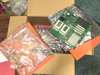

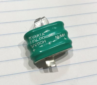

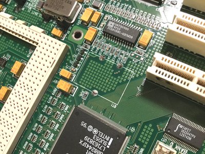

Saving as many of the new old stock ALR (Advanced Logic Research) dual Pentium Pro server motherboards as I can from battery damage. So far no casualties thank goodness. All the three legged batteries had started to leak, but luckily I picked up this lot in time. A few more years or possibly even months and a lot of these boards would have been doomed or at least damaged.
While I was working on one of the motherboards the battery snapped quickly and threw battery acid powder into my face. Immediately washed it off. Luckily none got in my eyes. Why such expensive (at the time) motherboards would have these large barrel batteries on them is beyond me.

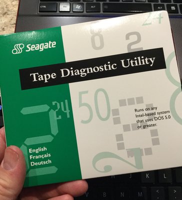

As I go through the Pentium Pro haul I am finding some old sealed utility software. Don't know if this needed archiving, but I did it anyway. You will find the floppy image below the photo.

It's pretty easy to find old hardware and never be able to find the software (looks askance at Dialectron Smart Answering Machine).
Storage stuff especially might turn important for data recovery. It's very easy to get a setup with backups and a dead HD and an obsolete tape archive, and the only copy of the backup SW is on the HD.
