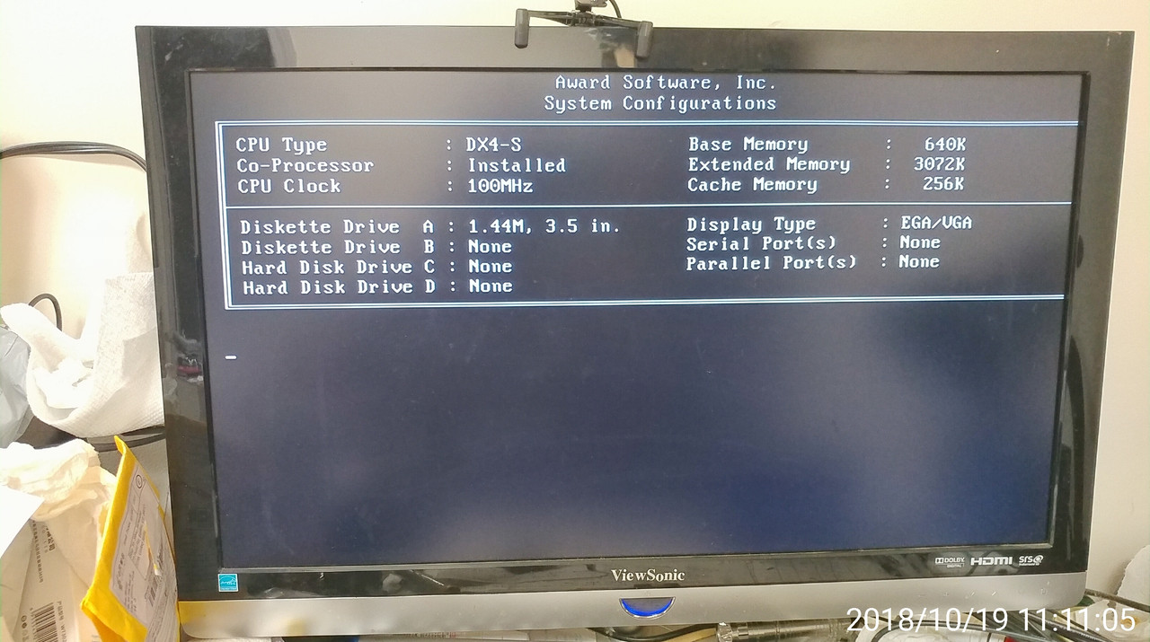

Continuing to work on the 486 motherboard from above posts... Soldered a VRM (I went with a LM338) and confirmed with voltmeter that it gives out the correct voltage... 3.41V, perfect. Soldered a few missing jumper headers, and also a coin cell holder which the MB had a solder print for but they went foolishly with the NiCd battery instead which leaked... won't happen again. 😀
Tested the new and inproved motherboard with some higher end CPUs.
First was a Intel Overdrive DX4ODPR100. The computer would not boot with it. Checked everything again including voltages and jumpers, all is good. TBH I had never used this overdrive, it may be dead.
Second an AND 5x86-PR75. Booted right up, recognized as a DX4-S

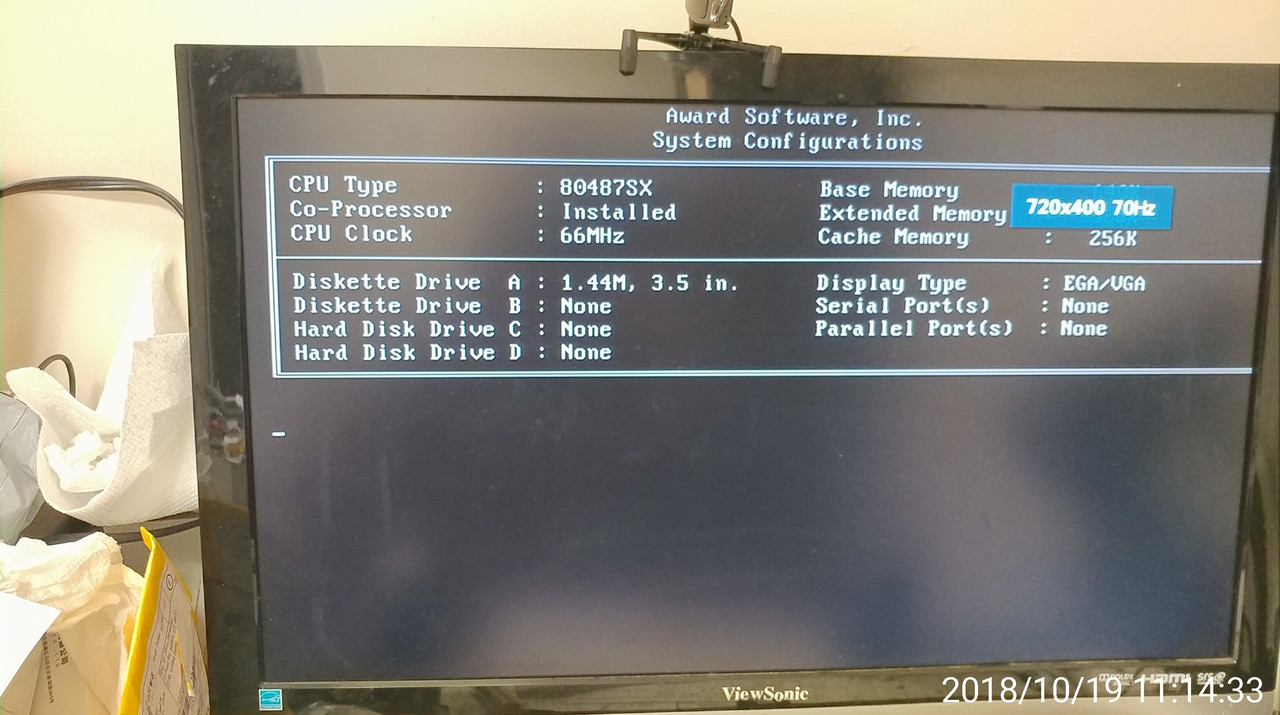

Next up, Cyrix 5x86-100GP. Lots of jumpers to change for this one.
It boots but only as 66MHz, and recognized as a 80487SX. 😀 Probably have to fiddle with jumpers more.

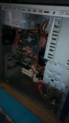

The board installed in a case, yes I know that the PSU is a crappy one but the Hipro that was originally in there has a very short ATX cable that doesn't reach the connector ;.;

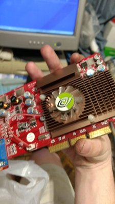

The Radeon 9600 Pro with an NVIDIA FX cooler .-.

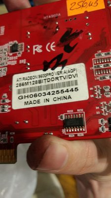

If you don't believe me... xD

That ATI card with a Nvidia cooler. 🤣
