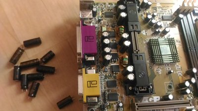

Saved a Slot A motherboard from a bunch of leaky and bulging caps. This Chaintech CT-7ATA now lives to POST another day!

Huzzah! Huzzah! And may your motherboard live a longer and more stable life!
