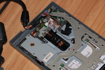

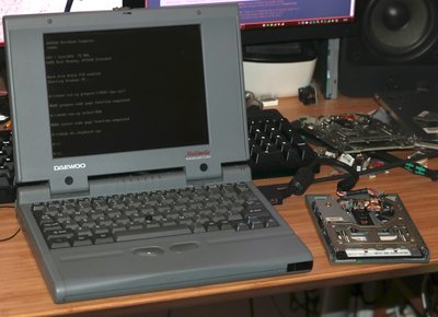

Today's thing has been getting a Mitsumi D359F2E floppy drive back to working - I now know how to fix the belt on these drives 😁 The drive seems to be unique to this little Daewoo DN7400 486 DX4 75 laptop (with sound! & DSTN 😵 ), so I can't do my usual fix of just replacing it with a non-belt driven floppy drive.
1.29 MiB
949 views
The belt was too stretched even after cleaning it off with an IPA wipe & getting it back to being rubbery, but I'd put another Mitsumi D353F2 out as rubbish - the belt from that is just taut enough to get the drive back to working. I wonder if there's a good way to store these to avoid further belt perishing?

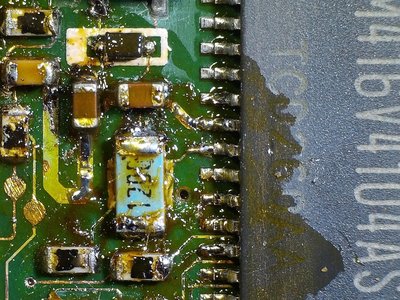

I'm also attempting to repair a very tired Libretto 100CT, which has had the battery leak onto the PCB, destroying a few traces around a memory chip and the keyboard controller. Even when those are patched up, it might just not work 😁
