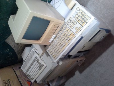

Went out to the shed and sorted out some of my old late '80s early '90s motorcycle stuff I'd had for decades. Yeah it's "retro" but some times you just have to say f&%k it get rid of it and move on. While I was there I'd thought I'd check up on Unhappy Mac and make sure he was behaving himself with the neighborhood kids.
1.34 MiB
1009 views
Seems to be fine at the moment, but you never know he'll pull some shady move employing the UX/IX card. Him, Andrew Acorn and Ami Amiga have some real nasty discussions on the topic. Of course Pharly 486 just keeps quiet and giggles quietly down stairs.

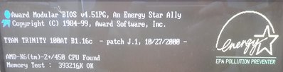

Super Socket 7 build incoming 😁
Updated my newly acquired Tyan Trinity 100AT (S1590S) with BIOS version B1.16c, patched by J. Steunebrink, to accept my (also newly acquired) K6-2+ 450.
