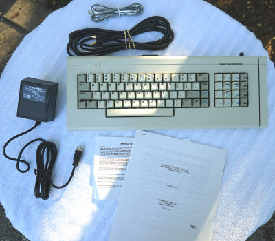

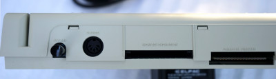

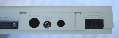

Some of you might remember, way back when, I offered a bounty on Vogons for a newer version of ITT Xtra DOS which has tools to get a proprietary ITT memory board working. A copy finally turned up on Ebay and I was able to successfully image the disks. Once I scan everything in I will get those up to minuszerodegrees.com.

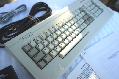

Also, I have been testing a new old stock Cardinal CP600 dumb terminal (circa 1988). Only has composite out, but looks like a clean video signal. Unfortunately, on a LCD TV, the video signal from the unit is blinking on and off like a reset alarm clock after the electricity goes off and on. Don't know if it's something bad on the terminal's PCB or the signal is having trouble being interpreted by the LCD. Will test that tomorrow on a CRT.

Wow! The thing is looking like brand new!

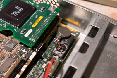

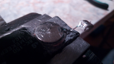

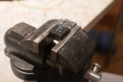

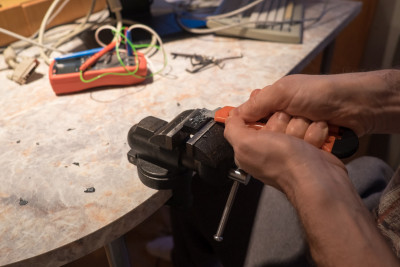

"Fixing" the dead battery issue in a Dallas chip using a cheap $1 knife...

That surely works, but I prefer to do it right and make it look good.
It looks like the original battery is still inside. If so, I would not consider it done right.
Btw this is not the final stage - I will cover the internals of the chips and add a proper battery holder. This was just a quick test - the battery inside started to "expand" and there were small signs of corrosion on the battery contacts. Thus, I didn't want to wait with the removal of the battery.
Vintage computers / SGI / PC and UNIX workstation OpenGL performance comparison
Reply 13857 of 27649, by derSammler
The internal battery is disconnected. There's no need to remove it by destroying half of the chip. And there's no need to worry about leakage. This won't happen (to anyone: show me a Dallas chip with a leaked battery that caused even slight damage, or shut up) and even if, it's completely sealed by compound material and it's a lithium dry cell. In the very worst case, it may damage the clock chip a few millimeters away from it inside and then you can just replace the Dallas chip anyway. But again, this simply won't ever happen. It never did.
Reply 13858 of 27649, by diagon_swarm
1.88 MiB
1218 views
(I know, not a good photo...)
Btw I don't expect that a single Lithium cell would destroy the computer. I just didn't want to buy a new dallas chip for SGI Indy. This fixed one will outlive the rest of the machine and that's all I wanted.

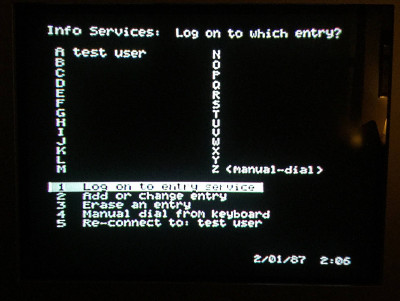

Well, good news on that Cardinal CP600 dumb terminal. The composite video signal coming out of it did, in fact, not jive with the LCD panels I had to work with. Tested it on an older CRT and a nice, clean, stable video signal came through. Excuse the crap photo as I only had my phone camera at the time. You can switch between 40 and 80 column text mode with a keyboard shortcut. Cool little dumb terminal for an easy serial connect with pretty much any system you want.
