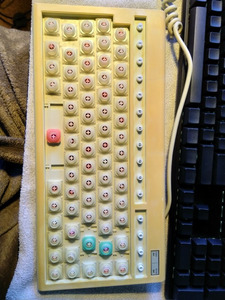

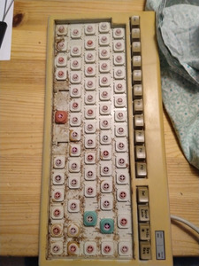

A filthy little keyboard missing a keycap and stinking to high heaven of stale tobacco smoke.

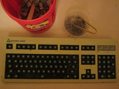

Removing the keycaps it looked even worse:
99.08 KiB
1447 views
Looks like coffee...

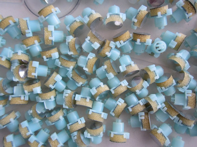

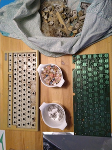

So dumped keycaps and membranes into a pillow case for washing in the washing machine and set about disassembling the board:
112.55 KiB
1447 views

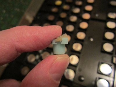

BTC foam and foil. Never my favourite keyboard technology- it combines rubber-dome-like keyfeel with mechanical complexity. At least the capacitative sensing gives full NKRO. Still, vintage is vintage and the foam pads are in better shape than on my other foam and foil board. Interestingly, there are some penned-in legends on the back of the slider plate. Somebody has disassembled and reassembled this board before - and then spilled coffee over it and used it as an ashtray...

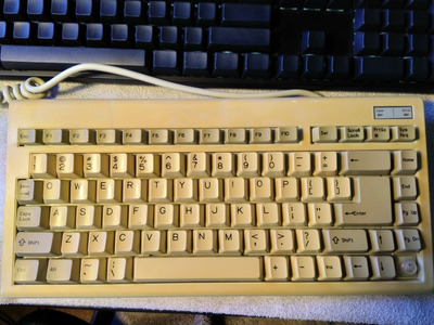

Adding cleaned keycaps:
159.69 KiB
1447 views
Much better. Shame about the missing right arrow. Due to that and my general lack of enthusiasm for foam and foil I can't be bothered to retrobright it, but it's fully useful with the (equally yellowed) mini-PC I got it with. Now to sort out the RTC on that...

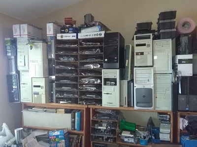

Did a little bit of spring cleaning. It's an ongoing project now that I'm getting stronger instead of weaker. Lots of fiddly detail work in the last week, sorting and packaging small parts, cables.
Discovered that I can cut a USPS Medium box in half lengthways and a lot of non-full-height cards will fit in them (line it with anti-static wrap inside). They also make good motherboard storage, you can see both in the pic:
download/file.php?mode=view&id=79341
I did a stack before and it kind of leaned, not trying to set them at an angle helped and it's not like anything is falling out. The USPS half-boxes have a ton of models, NICs, low-profile video cards, serial/parallel/USB, etc.
Still figuring out where laptops and monitors are going to go, some of them are up on shelves but still some on the floor. Those early 286 laptops take up a *ton* of space.
I'm personally under lockdown for medical reasons but when I'm not I'll be selling some stuff, and I'll probably give a few things away on the giveaway thread (if it's even still up). Now that I'm healthy enough I have got a lot done I couldn't do before.
I may have lost the sheetmetal cover for an old AT U-tron case and I'm a bit annoyed about that. It's possible I'll still find it, but it's not quite a standard width, so 🙁.

Nice collection! Is that the DTK tower on the left? Anyway, the giveaway thread has been rather quiet lately for sure.

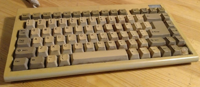

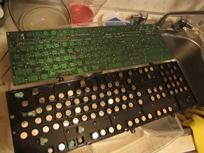

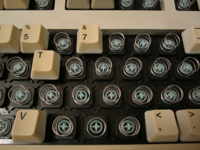

Whereas foam'n'foil is pretty straighforward. I did this 1993 BTC-5369 recently. I remain astonished that the foam holds up. This tech isn't my choice for typing either. It /might/ be okay if you could just feel the contact point. The softness is fine, it's the vagueness that bothers, I think. These are quite worth saving for a gamebox spare though.

Yes, that's *the* DTK tower. 😀
