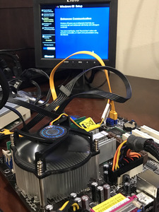

Installed Windows 98SE on an Asrock 775i65g with a Pentium E5800 LGA775 3.2 GHz CPU manufactured in 2010.
Board has an AGP slot too.

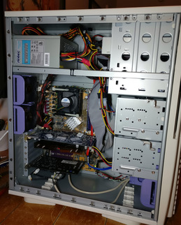

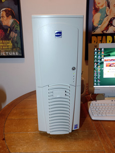

put the finishing touches on my pentium 4, 5950 ultra build.
installed all the fans and added another dvd burner just because.
and of course, the most important part, the pentium 4 sticker 😎
this ones all ready to go back in the box.

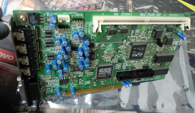

Recapped my MAXI Studio. The original caps were damaged when I got it, and they were from GSC.
It took about 4 months to finish this as everything had to be done in spare time.
Few tips for those looking into recapping the maxi.
  • A Hotair station is your best friend. Few through-holes holding some critical caps have the largest ground plate I've ever seen so far. Daymn.
  • I used Nichicon KT series which happens to be 5mm in diameter (1mm larger than the original) and 12.5mm in height (2.5mm taller). It fits right in w/o any problem whatsoever. Other caps in the similar size are... well, you just need to look it up.
  • C82 needs to be bent in 90 deg. It interferes with memory.
Here's my capacitor map.
25.63 KiB
1335 views
The final difference in sound? Not so much other than the fact that the new caps would last forever.
* EDIT : The old GSC cap is 10mm tall, and Nichicon is 12.5mm in height.

thank you :3
I'll keep that info in case I ever need it as I just got one of these ^^ Re: Bought these (retro) hardware today
