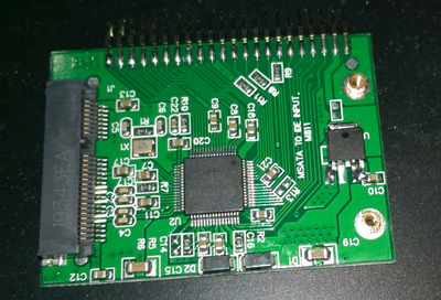

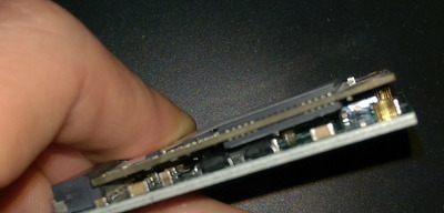

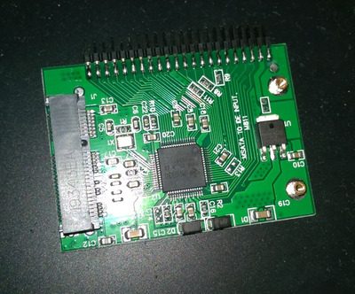

Had to desolder voltage regulator, bend the pins and shift it a bit, because of poor placement on a mSata - IDE adapter... (flash chips were touching the edge of regulator)

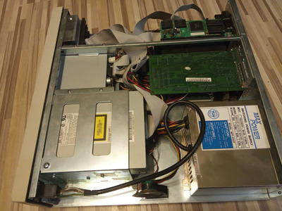

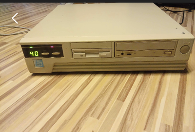

I managed to assembly my Dell Optiplex GXa. After over one week of retrobrighting the case, it is finally done. There is one thing left - CD-ROM is still "in progress".
I replaced Pentium II 233 to Pentium III 500, it runs at 66 MHz bus thus the CPU clock is down to 330 MHz, but I got SSE instructions and it is a lot faster than Pentium II. The ram has been upgraded from 128MB to 384 MB.
I installed the Voodoo 2 12 MB PCI card.
I ordered SGRAM extension (2MB). ATI Rage Pro will have then 4 MB of total VRAM.
Take a look at the pictures 😀
I will demonstrate this PC later on Vogons once it'll be ready.

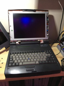

I was going to 3d print repair parts for this PMD-5500 486 laptop, but decided that just squishing some Polymorph / whitemorph plastic in would be easiest, since hinges don't get too hot normally.
Then getting Windows 95 installed on the laptop, which sadly had a totally dead hard drive so I used a Toshiba 810mb drive, which is working great. Thankfully the drivers are the same as desktop ones, with the Terratec Maestro soundcard drivers working nicely for the CompuMedia ASC-9308 sound chip.
The Vanadium Lithium VL2330 rechargeable cell was bad and its low voltage stopped the laptop (with AMI WinBIOS) from booting. I'm genuinely surprised and really pleased that I had a spare VL2330 cell to replace it just in my box(es) of parts.
When I was repairing the screen, I was worried because the corner of the screen that I heated with a hair dryer to reshape the thermoplastic went white from the heat. But it went back to normal once it cooled down. Which is great, screens for computers this old are difficult to get.

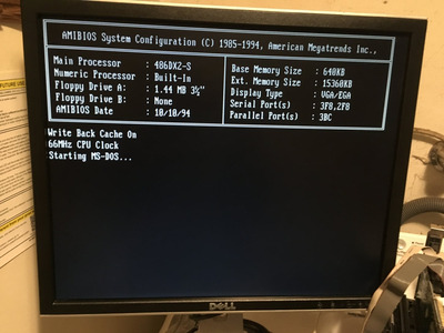

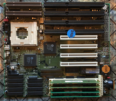

Got a PCChip M915i / Amptron DX9200 up and running. Was giving bootup issues. It has Fake Cache chips but wanted to make it run ok before attempting to put sockets and real cache on it.
Works ok now and ran lots of tests that all worked fine except NSSI, it hangs on BIOS/PnP detection (which the board does not have PnP 🤣).
Probably related to the fake cache. One more board moved from the "To Fix" pile to the "working" shelf. Will do the cache implants later....

ElBrunzy wrote on 2020-12-28, 07:52:
I hate those socket board there they put 2 16 bit isa board that will get in the way of the cpu heat sink !
I doubt there will be an issue at all. My 60 or so 16-bit isa cards finish at the end of the slots.
