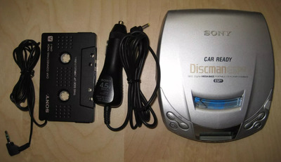

Not PC retro related, but today I tried to play a CD on my discman sony D-E406CK: (pic is not of not my actual discman, but it is identical to mine)
However it would not work. It turned on the screen for a second, turn the disc about 2 degrees and power off again. So I disassembled it, did some tests and found that the lens was not moving. I had to disassemble the whole lens assembly, lube the gears and re-assemble the discman. To my relief, after this it worked again without issues.

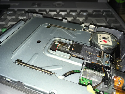

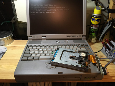

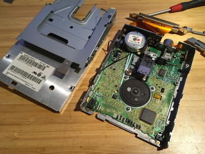

There is a gotek for laptops, or a half-height one at least. But it's a weird 720K drive and useless without FlashFloppy / HxC. The connector doesn't work with most floppy drives I've tried yet. Sadly the connectors for laptops are so varied and non-standardised that it's a non starter for most folks, I Think.
You could make a PCB that goes into the Toshiba's external floppy port, or that goes into the multi-bay port that connects up to a Gotek, that's doable probably since the Gotek is just a microcontroller and doesn't need much power to work. If there's interest, I wonder if I could design one. The regular Gotek is certainly more expensive now.
You reminded me I have a belt to fix from one of my Toshibas though! You can 3d print out a belt in TPU and that'll get the drive running again. Needs to be printed with a 0.25mm nozzle in vase mode with no skirt. Once it's printed, use nail clippers to cut off the filament blobs on the belt, give it a stretch and it's ready to use.

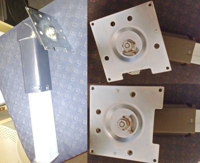

Was just talking about this on another forum, thought you guys might find it interesting too. I dug this out of my gear stash after seeing LGR's recent-ish video "Testing Two Nifty Old LCD Monitors".
261.91 KiB
1305 views
Rough shot (sorry) of the rotation mechanism behind those 90-degree rotatable Viewsonic LCDs, which I kept after deconstructing one years ago.

Probably, sorry for not getting back to you. Send another PM, covid messed up stuff for a while and I'm just kind of getting over it all now. I've found that 0.25mm nozzles are best over the regular 0.4mm nozzles, but TPU isn't supposed to support that, so it's on the edge of what 3d printing can do.
Can you detail which model / sub-model so I can work out what length is needed?

Wow OK. Similar to the ones on some more expensive BenQ and Dells. Have one similar sitting in the piles that with base plate was just too good a build to toss. Wonder how many of the better monitors it would fit ? just rambling...

🤣,…..Back in 1980’s I had one of those in my truck. It had a cassette deck so I had to use the cassette deck adapter for the Sony CD player.
