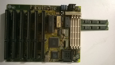

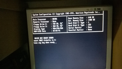

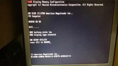

Restarted my old PC, it is a 386SX with a 33 MHz AMD cpu.
The MB is a GMB-386SAL with a soldered 386SX cpu, it currently has 2MB of ram, but if necessary I can easily upgrade it to 4MB by adding two more 1MB 30pin RAMs.
The coprocessor is missing, but for DOS use it is not a problem, the VGA is a 256KB Hualon ISA.
If I wanted, I could add an ISA sound card, but I don't know if it can be used, maybe it could be used for some video games, but most use the PC speaker.

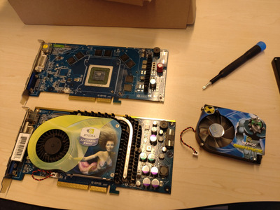

Swapped the cooler from a dead 6800 GT and installed it on a 6800 LE, because Nalu. And memory cooling for what it's worth.
Unlocked the extra pixel pipelines and vertex units as well, without artifacts.
Today was a good day.

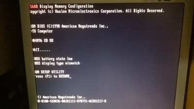

Today I expanded the RAM to my 386SX, now with another 2MB they are at 4MB total, for the moment it is the maximum amount that can be installed, because I have filled all four SIM holders. Wanting and finding modules of 4MB each I could, by finding a couple, further expand the RAM reaching 10MB total (8 + 2), there are modules of this capacity for sale, but the prices are not so cheap, perhaps with some experience ( ?) you could do some mods to expand the capacity of the 1MB ones, I don't know if it is possible to combine two of them in order to obtain modules of 2MB each.
