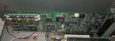

Testing out games on my upgraded XP machine ran into an issue when testing Far Cry. I started getting extremely loud coil whine from the system.
Naturally since I had just replaced the motherboard and CPU, I assumed that the new hardware was the culprit. I then spent several hours playing with BIOS settings changing voltages, power management options, turbo settings, etc. Nothing worked.
Finally realized the problem is just Far Cry. I didn't realize that the game doesn't have a frame limiter and it was rendering hundreds of frames per second and pushing the system to the limit.
Forcing vsync via the nVidia control panel solved the problem. No more coil whine.
Screw you, Far Cry. You wasted my evening.
The game does have its own v-sync, it just doesn't work.
Isn't coil whine wonderful?

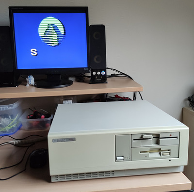

After 3 damn frustrating days,I finished my latest buy from my regular e-waste supplier.
It is in very good shape. CMOS battery was empty so I replaced it with a 2x2032 coincell holder so that solved problem number one.
Problem 2: setup config error but this has to be done with a setup file/floppy which I didn't have. Gsetup kinda worked but kept giving me setup errors. Getting this on a 5 1/4 floppy was also an adventure which involved a P3 laptop to make a 3,5"floppy, several pc's to find one with a good working 5 1/4" drive and finding some healthy floppy disks.
At least the HD was recognised now but this gave me problem 3: HD error code (HD is a Seagate ST-225 BTW).
I wanted to see if I could revive it to look at all the stuff on that whopping 20mb! Using Spinrite to repair it was taking like a predicted 40 hours so I decided to try and format it with DOS 3.1 which somehow was not really working so I found a working version of DOS 5.0 on 5 1/4" disks. Format went like a breeze, no errors and the hard drive still felt and sounded happy.
Problem 4: the 3,5" drive was wonky so I wanted to replace it. For some reason, none of my spare drives were seen by the PC so I opened the original drive,cleaned the heads and regreased it.Bingo!!!
Problem 5: that pesky config error,having to press F1 all the time, had to go so I went on googling and found a thread on a French forum which lead me to HPmuseum, where after trying some different files,I found the right one I believed. Had to convert it using HxC floppy emulator software from Teledisk format to IMG file,then use my P3 laptop to write the IMG with Winimage to a 3,5" floppy and then fingers crossed....
Well it worked! Config error gone and I have some extra utilities to explore including speed change tool, a memorytool etc....
Today I hoped to finish the quest by adding a soundcard but.....problem ummm 6?!
I decided to use a Mozart OTI601 card but finding the correct driver and writing all the different ones I found on a floppy took over 1,5 hours 🙁
I kept getting 'No Mozart card found' ALL THE TIME. I even tried an identical one I but same thing. Reseated the first one and tried one of the many drivers again and......It works!
Tested SQ3 and now I'm going to put this PC from hell in a corner 🤣. I kinda got tired of this one pffff...

Sombrero wrote on 2022-11-29, 10:45:
That's what threw me off at first. It lists the v-sync in the graphics options, but apparently does nothing. 😒
Ugh. My least favorite computer noise.
